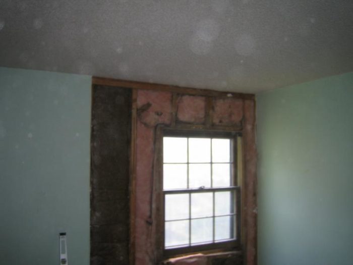

This is a picture of my own house when I moved in.  I think there might be something missing.  Any Guesses…..
Actually the pictures are a couple of posts later.. Sorry for the mix up…

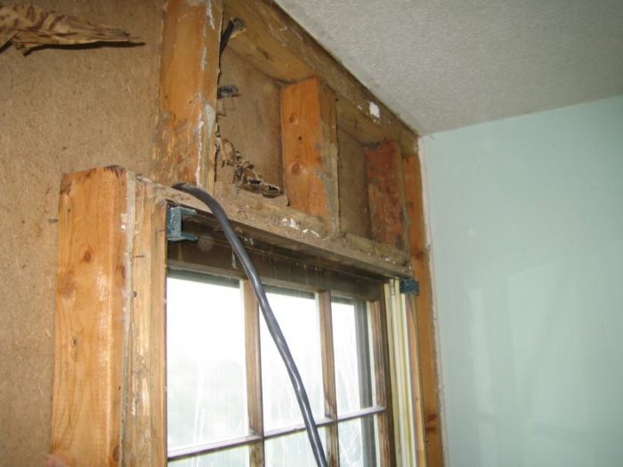

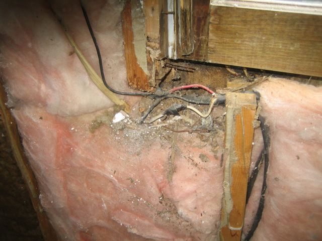

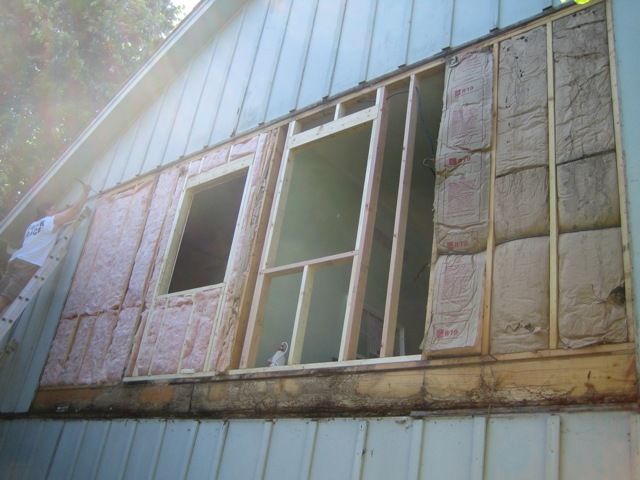

  2. howhighlites | Jun 01, 2006 01:28am | #2
    Nice House!
    Is that one of those old in wall heating systems, where
    the bare wires help dry out the water from the leaking window?
    Howie
    1. butch | Jun 01, 2006 01:46am | #7

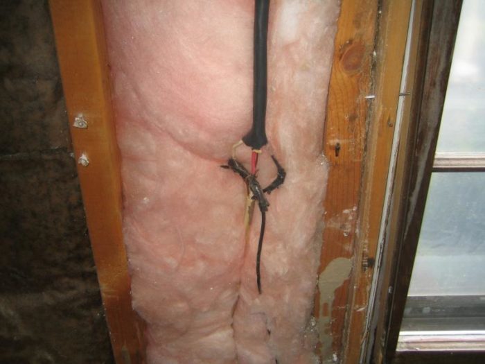

      <where<the bare wires help dry out the water from the leaking window? No, Silly boy,...... the wires are there to support the top plate:-)
      1. howhighlites | Jun 01, 2006 01:54am | #12
        Ohhhh.....
        My bad! Can't say I've ever used that structural technique before.
        Skills that were lost with the pyramids!
        Edited 5/31/2006 6:56 pm ET by howhighlites
        1. butch | Jun 01, 2006 02:09am | #14
          Thats otay..just a rookie mistake:-o
  3. kcbuilder | Jun 01, 2006 01:44am | #6
    Okay sorry for the mix up.. Here are the attachments in non LSD form...

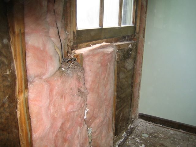

    2. Hackinatit | Jun 01, 2006 01:52am | #10
      My confidence in mankind slips farther into the abyss every time I see one of these things done on purpose.
      Can't be that someone was paid for that....Troy Sprout
      "Don't forget the screws"

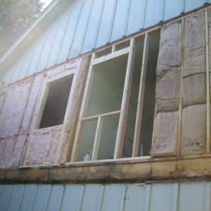

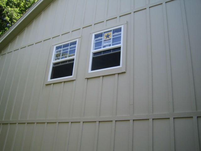

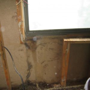

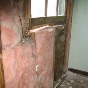

      1. kcbuilder | Jun 01, 2006 02:04am | #13

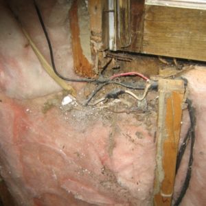

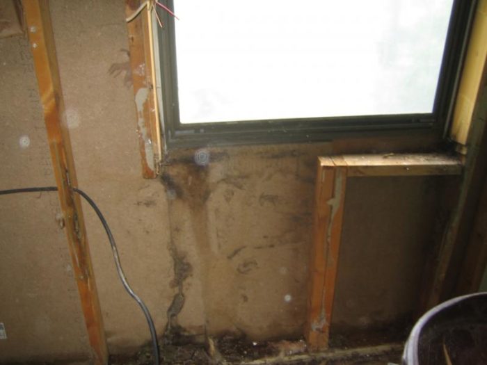

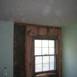

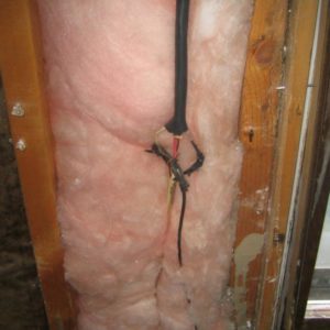

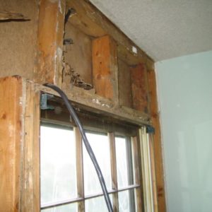

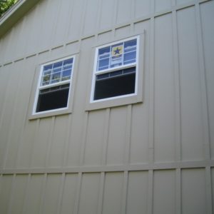

        This was a bank repo drug house and it happend to be my first home purchase.  I knew that the window was leaking ( obviously ) not to mention the termites but when I pulled off the sheet rock I almost cryed.  Oh yea, on the outside the put the brick moulding on the outside of the storm window.  Basically at this point I had to reframe the wall and replace the exterior siding.  I actually got all that done within 3 days including caulk, prime and paint by myself... Pretty proud of that one... This was pics from just one of the two windows on the same wall... Pics to follow...smaller pics that is...
        The wire in these pics was spliced from 14G to 12G once in the insulation then under the leaky window > once under the leaky window it went back to 14G.. Fun, Fun
        The rim joist only had surface termite damage in case you were wondering why it was not fully replaced.
