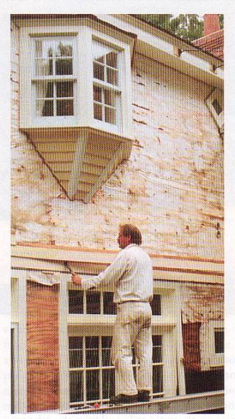

Somebody go find that old FH pic with the deteriorated housewrap under the cedar.
I know I remember seeing it. It wasn't a full page photo but maybe just a quarter page or smaller. Had a write up by it too. Back a ways before issue #153 I know 'cause #153 was ...well... it's a strange thing ya know I remember back in ...
"Somebody go find that old FH pic with the deteriorated housewrap under the cedar."Yes, I would like to see that ONE picture.Instead of guys reading about it and hearing stories about it here, I would like to see pictures and pictures of this.I'm still not believing this.Joe Carola
Roar! Really Joe, I remember quite a ways back a pic with a little writeup about it in an old FHB mag. Kinda like a little news blurb thing and not an article.
It's too late now but if no one addresses this I'll go hawking thru the stack sometime and scan the page right here, regardless if Uncle Dunc will report me to the management and hang me from my

Here is a link to the article which shows the house in question. It's issue #137.
http://www.taunton.com/finehomebuilding/pages/h00150.asp

At the risk of incurring the wrath of UncleDunc here is the pic.

Thank you Rez.That's one picture so far.Joe Carola
I believe that's the one I was thinking off.
I know what yer looking for: close up shots of before and after.
Kinda like the pressuretreated tests of PT driven into the ground and monitored over the years.

Andy and Mike, I'm with Framer, rather than anecdotal "evidence," where can we see the real degradation? I want to build well, too, and if tar paper is the stuff, I'll go back to using it. But, I've still never seen anything other than discolored Tyvek under cedar...show me the breakdown<G> "what's in a name?" d'oh!
See if that discolored housewrap is watertight.
I'll stick with felt. It's well proven, has no anecdotal reports of breakdown, is cheap, and seals around nails to some degree. I don't see what housewrap does that felt doesn't do (except cost more), since I doubt housewrap's worth in keeping wind out. Andy Engel

It's not at all clear from the picture what happened. It could be that the paper was left exposed for months before the siding was installed. If that's not the case then either the guy's back is to the beach or the siding job was pretty crummy.

The article doesn't address the siding material as much as it does water intrusion. The short story goes like this: Sheets of flaking paint, hmmm there must be a problem, remove a few clapboards and everything is soaking, but wait, the siding was installed right, flashings were good...enter Joe Lstiburek who says water WILL find a way to get behind the siding no matter how well it is installed. If it can't get out, big problems. Solution says Joe: rain screen walls, and backprime of course to seal tannins, sugars, and detergents (all of which are surfactants) that can bleed and cause the housewrap to loose repellency.

You don't get that much water intrusion unless something's wrong.Also, from the picture it's not clear that the Tyvek has in any way failed. It is true it is stained, but there's no evidence that that has caused any problems.

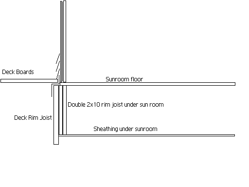

I'm curious - why do you think it would be a good idea to cut out the Tyvek? My bigger concern is really one to do with the way the deck that adjoins the sunroom was flashed. As I got underway with this project, I saw that there had been some water intrusion under the sunroom, in between the rim joist for the deck and the rim joist for the sunroom. When I pulled off a couple courses of siding, the flashing that sits over the deck rim joist is in between the BildRite and the siding, but not behind the Tyvek. As such, any moisture that actually reaches the Tyvek will drain down in between the Tyvek and the BildRite, and never hit the flashing, thus going down into the insulated cavity below the sunroom. I can't think of any way to correct this other than to remove the siding, re-wrap the house (or at least the sunroom), re-flash, and re-side.
How much is "some" water intrusion? How did the water get into the wall in the first place?
It's hard to say where the water came from - either from above the bottom plate (i.e., through gaps in caulk around windows, etc.) or from at or below the bottom plate - the deck is built so that the deck boards basically but right up to the starter course of the cedar siding. I've attached a simple cross section diagram to try to show what's going on. The water is coming down in between the deck rim joist and the double 2x10, then running horizontally into the first joist bay above the sheathing under the sunroom floor.
Mike, it sounds like you are just getting water in behind the siding. Dont worry about the Tyvek being on the inside,its not really a moisture barrier anyway. I cant see your picture ( jpg mode is the only one that works with this ancient system). Before you do anything drastic like residing, just check your seams, caulk joints, flashing, etc. If its getting in a seam, try to carefully loosen the siding at the seam and slide a 1" wide piece of tar paper up under it to the top of the siding. Make sure it covers the top of the row under it. Tap the siding and nails back in and cut the exposed tar paper off with your knife. Its worth a try, Good Luck.
