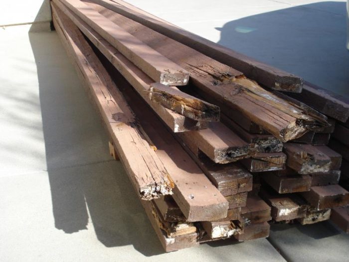

Resawn Doug Fir is just a rough sawn look. I hope the pictures that I took will help if I am able to transfer them to this site properly in a internet size format.

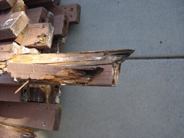

One thing to notice is that the header element that I left on the patio cover along with the 2 x 4's are in good shape due to the fact that they are under the eave so no sunlight or rain gets to them. The ends of the 2 x 4's in the stack that look decent are the ends that were butted in the center of the patio cover. They weren't damaged as much as the ends for some reason. I think that maybe some of the primer and paint rolled down them as they were being painted before the installation. Those pieces also have two three penny nail holes in them. Can I just cut off the damaged ends and re-install and if so what product do I use to fill the old nail holes and missing pieces of wood that came off during the removal? I had planned on repainting the whole structure either before Winter or after Spring of next year, but obviously upon review last weekend before the removal was done, paint now is eminant. Most all of the patio cover paint wise is good as of this date. A local lumber company stocks this resawn lumber. I also had to remove one of the 4 x 6's due to a long check that decomposed that piece.

BTW, that wood looks pretty bad for only being 6 years old!

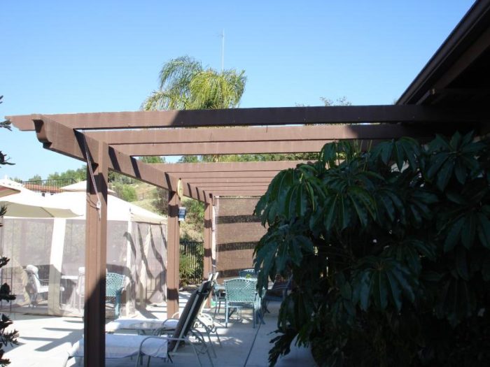

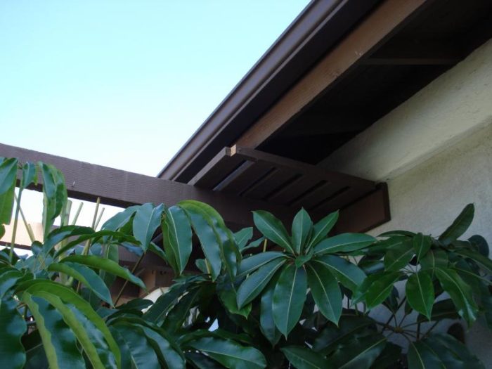

Was there any landscaping laying on (or against) this wood? The pictures sure look like water damaged wood and I've seen this in situations where branches lay on patio covers.My neighbor is replacing her redwood patio cover after several years of letting a redwood tree branch lay on it. The cover stayed wet all through the rainy winter, and well into the summer because of the deep shade from the tree. I did some minor repairs over a few years but couldn't convince her that the branch needed to be cut back so air could circulate.
I am trying to figurer out what you mean by 'patio cover'
Was there some sort of fabric stretched over this quasi-pergola?

backpriming those ends might have helped a little.... but really..
it was just not built to last
you have some detail in the design that diverted and trapped water
this is way beyond backpriming

resawn from what - most of the 2x in the first pix are only 4 or 5 growth rings and sawn from the log center - those puppys were NOT resawn, sawn from scrub ends is my guess, 'resawn' from rejects or larger boards maybe. The 7 or more growth ring stuff looks ok.
Is that a mister in amoung those plants? How are the plants watered? Where does the moisture come from that caused the rot?

Looks like to me the guy started off with bad wet lumber. Maybe stuff he had sitting around, cut it down told you it was resawn.
when he primed it sealed in the moisture, your hot dry days acted like an incubator for the rot.

Wow, that wood is really rotted for being only 6 years old and suspended in the air. I've seen DF in ground contact, wet locations, hold up better.
One thing that can account for premature rot is that they lay flat on your pergola rafters. They can cup and hold water more and if they split, the water can then enter and get trapped because the boards are mostly sealed on the exterior.
Not priming/sealing the endgrain had nothing to do with this in my opinion.
All in all though, for non-treated wood, 6 years is beyond any reasonable period for the expectation of warrantee, unless you have something in writing to the contrary.
I say, put in new ones on your dime. You should have well under $100 in materials and a few hours labor to replace.
Use a resistant wood this time and you'll definitely get more years. Stand the wood on end instead of laying flat and you'll get more years with any species of wood.
Are there any special conditions in your partio area? watering, chemicals, misters?

I'm wondering if that's actually fir, it's hard to tell. If it were hemlock--very similar looking in some cases--it might go punk like that in 6 years. I have VG fir trim on my house that's 90 years old and still good for a few more.
I was wondering that too. I meant to ask how he knew it was fir.
I refuse to accept that there are limitations to what we can accomplish. Pete Draganic
Take life as a test and shoot for a better score each day. Matt Garcia
agreed on that too. My fist thought on those photos was, "Boy, they get some poorer fir out there in CA than I do here all the way across the continent! Junkyard noticed it too.If this guy has a cpontract that speciefied Doug Fir and if this is not DF, then he has a case. Otherwise it looks like lack of maintanance.
so far, that is the way my opinion is leaning too. I also think that is a latex stain and not a paint. The end grain rotted worst because of no preseal there, but the whole length seems to have problems from what I see in the photos.
