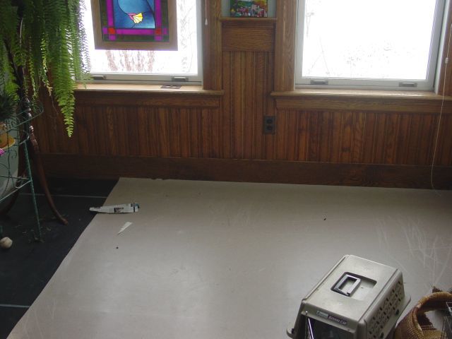

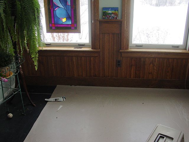

My wife would like a window seat along this wall. I’ve got enough of this salvaged oak wainscotting to panel the front.
How tall and deep do you who’ve made one make it?
