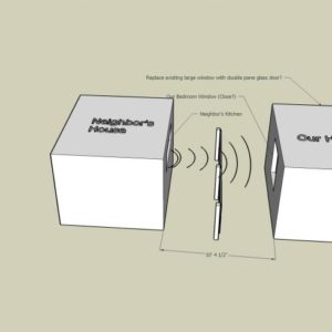

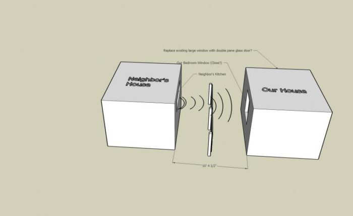

We have a bedroom window that sits about 10 ft away from our neighbor’s Kitchen (please see diagram).
Our house has stucco exterior and plaster interior walls.  I am considering permanently closing off the bedroom window, adding 2 layers of Blueboard sandwiched with an acoustic glue followed by veneer plaster to hopefully reduce the amount of conversation we here from the neighbors.
In addition I would have to replace an existing window (approx 84″ x 24″ window) on the wall perpendicular to the window to be closed with a double pane sliding glass or french door to meet fire escape requirements and compensate for the loss of light.
My question is how much will this help dampen the noise from their kitchen?  My intuition is this will help make the conversation we hear less intrusive, but I can find no information to back this up.
Thoughts anybody?

      1. tedn | Dec 23, 2008 08:00pm | #7
        Since the view is really of the neighbor's house, I have no interest in keeping the window.  The only downfall is I will lose some light.
        My plan was to fill it in with a couple of 2 x 4's, fill with R-13 insulation (no exterior insulation is present) and then put another layer of sheetrock followed by accoustic glue (e.g. Green Glue or QuietGlue) followed by sheetrock.  This should help with the sound ratings, but since there is another window around the corner about 6 feet (see diagram), I'm wondering how much of the sound will just shift to the other window (even though it is around the corner).  Can't seem to find any information of the relationship of sound to direction.

          "I'm wondering how much of the sound will just shift to the other window (even though it is around the corner). Can't seem to find any information of the relationship of sound to direction."Around the corner will be considerably less noise for two reasons:
          1. The distance is greater. Sound energy drops as the square of the distance - twice the distance = 1/4 the sound energy.
          2. Sound bending around an obstacle diminishes as well - consider the effectiveness of office cubicles and freeway sound walls. Visualize ocean waves bending around a point or breakwater. They are much smaller than waves in the in the straight-on direction.Another possibility might be a "storm window" of laminated plate (like auto windshield glass) whose shear density decreases sound immensely. Certainly if you close up the window and install a glass door in place of the other window, you can specify laminated glass in that door.Is it a one story house? A skylight would get you lots of light. BruceT
