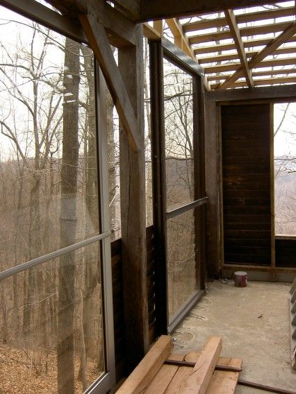

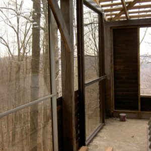

    If you can be flexible with your design, opportunities abound.  Here's a $1/ea purchase I built into mine.  At one time, 2 of the large panes were doors in a truck dealership.  The smaller (uninstalled when I took the pic) casement came from a client house, redwood single-glazed.  They wanted something warmer.  I didn't.

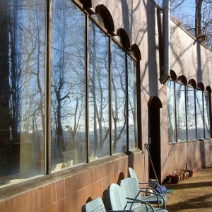

            Oooh, windows.  Second the motion for fixed glass.  Very inexpensive, function beautifully.  Here's our southern bank of low e (reflecting the winter view):PAHS Designer/Builder- Bury it!
