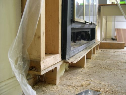

I never heard of this tool before joining this site but now I wish I had one.  I need to cut the OSB and 2×4’s under this fireplace insert, about 1/2″ behind the face.  Would the MultiMaster be able to do this with the circular saw blade ?

    1. Chucky | Jun 14, 2008 09:18pm | #12
      I'd be able to cut the 2x4 but i don't think I could do a good job of cutting the OSB.  If I was cutting flush to the face, I could but i need to cut it 1/2" back.

      I think he wants to save the metal fireplace unit though
  4. DougU | Jun 14, 2008 08:31pm | #9
    Cant you discounect that insert and pull it out to cut all the wood off? I have a MM but I think I could pull the insert out quicker. The MM is nice but fast it aint!

    2. Chucky | Jun 14, 2008 09:23pm | #13
      That would have been my first choice.  In fact, I would want to lower the insert to floor level.  Unfortunately, I'm not comfortable enough playing around with the chimney flue to add an extra 4".  I'm sure it's straightforward but I'm always concerned about insurance issue should the house burn down and I don't know if you need to be licensed to install an insert and flue.
      I was actually able to remove the bottom piece of metal from the insert.  It was screwed to the sides and a few spot welds on the bottom.  I can now cut it back 1/2" with my sawzall.
      Edited 6/14/2008 2:25 pm ET by Chucky
      1. Snort | Jun 14, 2008 10:49pm | #14
        If you can shim the front edge of the stove off the osb, you'd be able to use a multimaster... buy if you hit the bottom of the stove, you've toasted 20 buck blade.The circular blade wouldn't last long on the osb, I don't think... get some japanese tooth style 2 1/2" wide blades...or, like Doug said, pull the unit... probably much faster and neater If dogs run free, then what must be,

    Since you need to cut the wood back to 2 inches under the fireplace, the multimaster is the only tool I can think of that would do it effectively.

    Funny looks the way my fireplace did. I hated it raised up and removed all the wood. But in my case I had access to the back of the unit from the garage. Just remove the sheet rock on the garage side it was not finished. If you can get access remove the screws on the straps that attach it to the floor give it a shove it will side back do your cuts then slide it forward and reattach.
    In my case I lifted it up a bit at a time on each side with a pry bar, added blocking under it till I could get two 2x4s under it with blocks supporting the ends of the 2 by (like a house jacked up getting ready to be moved) on the living room floor and garage floor. Then removed the flooring under it then and lowered it. the last section of pipe was adjustable height section,
