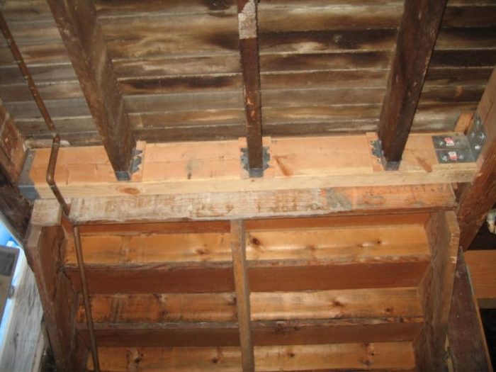

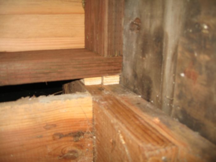

First up is this 4by6 beam that’s hung off the garage header and supports the joists for the porch on one side and the stair stringer on the other.
A closer look.

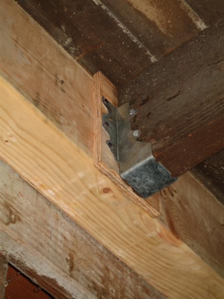

To me this looks like they cut those joists to short and had to make it up with a plywood spacer? To me this looks wonky-what do y’all think?

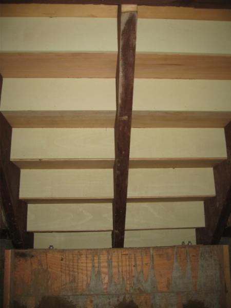

Second up- The new landing and 6 stairs they built. First off I gotta say that they want $2400 for this work which seemed steep to me. I told the carp that it better be a super grade a job for that kind of money and he assured me it would be. That he would use all vertical grain clear doug-fir. This is what I ended up with (he did this while we were gone for xmass)
Here’s an inside shot showing the ACQ stringers and plastic wood risers. For an exterior application I would think that all six sides of the wood would be primed and the cut part of the ACQ stringer would be primed also-they are not. I was also informed that I would have to caulk the stairs which seems like something the carp should be doing.
Here’s a shot of the underside of the landing.
Here’s something that I think might be wonky. The landing he built again appears to be 1/2″ short and he used plywood spacers? Is this okay to do?

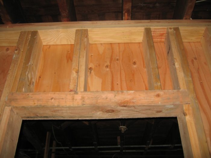

The SE calls for 4by6 headers in openings less than 4′. This is a header in a loadbearing wall with two floors above it. Should this header be orientated so the 6″ side is taking the load not the 4″ side?

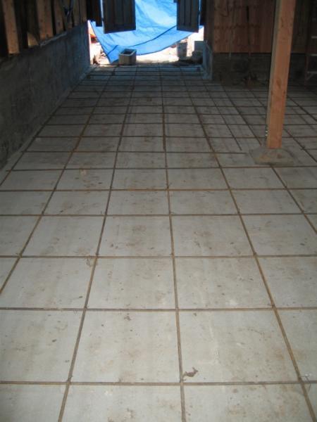

And here’s just a shot of the rebar grid tied up and ready for pouring(after we get the pex in)

your working on a old house with what looks like full 2" 2x's. so to get even in some places it takes a 2x and 1/2 ply.i think that is what alot of the 1/2 ply is doing,at least he didn't shim with osb.
if this was a new house some of this wouldn't fly for me . when your messing with a old saggy house ,coming down onto a new foundation,i would expect a lot of shim's and creative ways to make it work.
the one thing i would not like is the 4x6 header laying on it's side,i'd rather hac 2x4 standing on edge than that.if there is 2 floors above tha i do think it needs flipped.larry

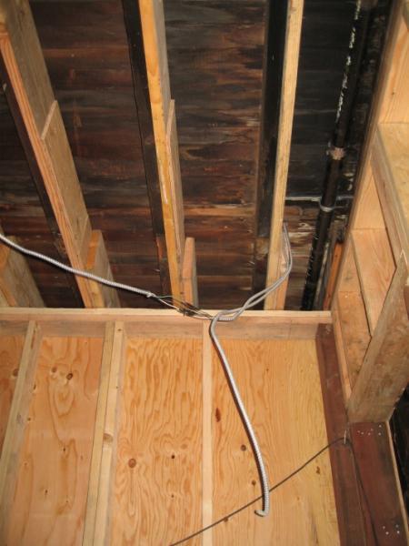

The spliced wire in pic 7 doesn't look right.
In the first pic, unless I'm not seeing it right, the simpson hangers don't look right. The 4x6 header has two different end conditions. If it is being supported by the two side members, then the left side is ok but the angle straps on the right are wrong. But I can't see the side ears on the left side bracket, so I'm not sure what's going on there. The three hamgers for the 2x joists look like they are one size too small for the joists.
Here's an inside shot showing the ACQ stringers and plastic wood risers. Doesn't look like acq to me. Looks like old wood.
Yea that wire hasnt been energized since we bought the place everyone just keeps workign around it...
The 4by6 is supposed to be hung from the joist hanger at both ends the one end on the left its attached to the garaged door header. The other end is supposed to be joist hangered with the same hanger to a new 4by6 beam installed just for that reason.
Is whats done then not a good idea?

There isn't anything wrong with the way that beam is hung at top of the stairs.

Under landing he used 2by4's. They are nails in the joist hangers.

I wondered why you showed the pic of the landing. Some things aren't evident on the pics.2x4 work if the span is small. I'd use 2x6 minimum if headroom wasn't an issue for small spans but I have had to resort to the smaller members in some unusual situations.I'd be worrying about the rise and runs with this crew. Remember to check things with the finish floor materials in mind. Bob's next test date: 12/10/07
I showed the landing because I was not sure about the 2by4 stringers they are spanning 5' and I wanted to show the T&G wood which to me does look like it is vert grain Doug Fir.
I havent measured the rise and run but that's a good point.

I am going to make them swap out the headers with the correct ones spec'd by the engineer. What other changes would you suggest?
Actually the wood post in the picture that shows the rebar mesh is load bearing its a #1 6by6 that a 6by10 beam bears on midspan. That post holds up a whole lotta house! The SE spec'd wood for it so its got to be okay right?

that pic showed some pretty even cuts ... certainly didn't looked hacked apart.
almost like someone planned it that way.

On the work and pics, original question;
It looks like the reason I don't have employees. It'll work - but its not the way I do things. If I had an employee do that, he'd be fixin' it. Or more often the case - I'd fix it and be one guy short on Monday. Either way, I don't do stuff like that.
Adequate yes but not craftmanlike.
Hard to tell the loads on the header.
Hard to tell the context of the pics, I wouldn't be jumpin' around with joy even if it meets structural requirements, no points gained for style.Remodeling Contractor just on the other side of the Glass City
Don't worry about Redeye. He's got issues, and has never posted any of his work but loves bashing others'.
I wouldn't worry about anything I saw in your pics, even the 4x6 header, but it's certainly within your rights to ask to have it changed. It's an easy change and it will let them know you're watching them.
I think the stairs look fine, plastic risers don't have the strength of wood but they're superior in most other ways.

mad, Please correct me if I am wrong here. The scope of the stair work consisted of two flights of stairs separated by the landing and included the new concrete landing pad. Now the carps had to tear out the old landing , tear out the old upper flight of stairs (lower flight was already gone as shown in pics), install the new header , which meant cutting back the floor joists, install new jacks, landing , and install treads and risers . Upper flight of stairs had to be removed and rebuilt without removing siding on either side of the stairs. Is that correct?
Couple of other questions. Why wasn't this work included in the original contract? Seems that it would have been obvious that it needed to be done. And , you did either sign a separate contract for this stair work or signed a change of scope of work didn't you ? Did the GC himself work the deal with you or did you talk to one of his carps and arrange it?
Like I say earlier in this thread I let convience win out over common sense.
Originally they were going to pour the CBS and I was going to redo the stairs.
I didn't talk to anybody they came to me (I was still planning on doing the work myself). The GC and the foreman of the job offered to do the stairs after the fact and in a moment of weakness I agreed...
We did though not sign a change order or a seperate contract about this job.

maybe I missed it but what was the outcome of the OP for this thread about the framing?
I think you missed it. He's gonna make 'em change out the header to a 6x6, not gonna mess with them on price. And he'll be a little more selective in the future about who he hires for what. And he's gonna quit worrying about the small stuff. Or something like that! =)View Image “Good work costs much more than poor imitation or factory product” – Charles GreeneCaliforniaRemodelingContractor.com
"And he's gonna quit worrying about the small stuff. Or something like that! =)"Which he won't because it's obvious that his nature is to worry! That's okay...somebody better watch out for the job. We know that carpenter isn't! Bob's next test date: 12/10/07
Thanks for the update. Personally I didn't think it was that bad. The header did need to be swapped and maybe some support at the top of the stair stringers. Other than that... hey - it's framing...
One thing I've learned is that as far as framing the GC needs to pay attention, and particularly to the engineering because if things go south, it's often the GC who picks up at least part of the bill. One thing I'll say for the OP - he did get the contractor to be the GC so no responsibility lays on the him (the OP). So the GC buys a new header and plays go-fetch. If the OP had of waited or not picked it up, there may have been wires all through it and who knows what else. Another thing I've learned about construction management is that you have to often accept the way other people do stuff and stop with all the "it's OK but I would have done it that way" kind of stuff. In other words pick your battles. If I feel like someone is delivering generally $sheet work I hold their pay until it's fixed and they don't get invited back.
Other than that I'll say to the OP that I only take 50% of what I read here seriously and seriously consider only maybe about 25% of that.

As a bay area carpenter, I'd say that work is maybe just slightly below average- but the price wasn't totally out of line. The stair treads should have been primed 6 sides, and the risers glued and nailed to the backs of the treads. There are a lot of carpenters, and companies for that matter, that don't do this. Seems strange for a coastal area like this, but that's what I've seen.Definitely get the 4x6 replaced with a 6x6. I would also have them add some nails to the plywood bits in between the joists and the beams. I.E, make a better connection from plywood to beam. Engineers around here in particular expect connections to be stressed in a lot more ways than one might think, so I wouldn't assume that the same # of nails will be enough if they're going through extra thickness.I would also get the carpenter to add some simpson ties from the stair stringer to the landing supporting it.Then again, engineers don't expect everything to be perfect. With a few minor quibbles, everything looks structurally sound.zak

I wouldn't say it is substandard, but I sure wouldn't be proud of it either. You notice that it looks like a novice carpenter did this.The contractor is primarily a foundation guy and house mover, not a carpenter. That is what shows.
You that reasoning makes perfect sense but when I was going over this with the GC he said they do rough framing all the time as part of their work. They usually have to at least reframe the kneewalls that used to sit on the old brick foundation. He sold his outfit as more of a one-stop shop compared to the other guys.

IMHO there is too much going on to evaluate by photographs. If you are having doubts about the work hire a third party, preferably a home inspector not another contractor.
I noticed something else. The sistered joists are overhanging the beam too far. I wouldn't give this a pass and I'm fairly easy. I also wouldn't let work go on while I'm not there anymore. These are rookie mistakes. It isn't anything near grade A superior carpentry. Id rate it below average. Bob's next test date: 12/10/07
This is what I am feeling. I may not be a pro but from reading a lot of FHB and this forum I have a slight feeling for what's quality work and this does not seem as such.
I could have a framing inspection with the SE what's the issue with the joists overhanging the beams to far?

Its your money. Look over the job daily but not while they are working. Remember, the squeaky wheel gets the grease but also remember that you attract more flys with honey. I prefer that homeowners stay engaged. I'd rather change things early in the game, rather than later and I truly want every homeower to be satisfied and happy. I don't want them simmering and wanting something different. Joist that hang over a beam too far can cause nail squeaks. Think of what happens when a load is placed in the center of that joist on the other side of the beam. We all agree that it flexes downward. Because of the cantilever, the tip of the beam overhanging is teetertottered downward. If it's only hanging over a short distance, it's meaningless. If its out there a bit, it's moving a bit. Eventually, it could work a nail loose by pushing the subfloors upward. Bob's next test date: 12/10/07
Man I'm feeling a bit like a sucker cause the $2400 was just for the 5by5' landing and the steps none of the other stuff you mentioned.
I think the most profound problem might be the member carrying the stringers. The stringers really aren't leaning on anything substantial. Their last riser is designed to hang down and carry the stringers but they've chopped a hole in it for the pipe. That leaves a very slim piece of material holding everything up. If the outside stringer are nailed substantially and securely to walls, this might not be a big issue. Additionally, the joist angle on the right of the stair headers look iffy. Instead of the joist hanger, they used two joist angles. It's probably enough but I don't know what the loading is.

The stair assembly is using an open stringer method. When that method is employed, the top of the stringer is installed leaning against the top riser. Because of the shallowness of your joist, that top riser takes on some structural characteristics. If the stairs stringers aren't nailed into the side walls, the entire weight of the stairs and humans on them are dependent on the top stringer leaning on that header and riser. It's hard to tell but I think you have 2x8 joist. That means that virtually none of the stringer would actually lean against the header if it was attached directly. The riser is sandwiched between the stringer and header and becomes the surrogate support. The problem I have with that assembly is two fold: the grain of the riser is running in a manner that would split easily and therefore won't be particularly helpful if a heavy load is applied on the stairs. The secondary concern is that the stairs are actually relying on the tread to remain nailed tight to prevent the stringers from falling down. I've seen stairs work themselves loose when assembled like this. We worked in one locality that required us to nail some form of hardware to the bottom of the stringer and wrap it up onto the header. For the most part, that was overkill but in some cases, the inspector was right. In this case, I would say he was right. I myself would have taken some other method to ensure a positive connection. The way it is built, the center stringer is useless.That brings up another point. The risers aren't nailed into the treads. And...I don't see any signs of glue. I wouldn't want plastic because I'd prefer something with more structural strength. The risers are a great component to provide structural rigidity on a stair system when glued and nailed. For a set like that I'd budget about 600 on a new installation. Yours is remodeling and it can easily triple due to demo and conditions. $2400 seems high but might be in line due to many various reasons. I'm okay with paying the 2400 when it is warranted but you deserve the top notch carpentry that you were promised. This guy might have done his best but it's below average carpentry in my opinion, which is widely ignored around here so don't lose too much sleep over this. Let me restate that nothing here is a deal breaker. If I was the contractor and you raised these issues with me, I'd rectify them all with an apology. It would take my guys and hour and I'd be unhappy with them for making me take that call. If I was the carpenter on this job and my guy did this when I was out, I'd make them fix it all without you asking me....especially because it was $2400!If we were pounding this out for some cheap azzed builder who cut us to the bone I'd tell him that it met code and still be embarrassed when I left. Or maybe not. It depends on my checkbook at the time and the backlog. Bob's next test date: 12/10/07
I did see glue oozing there, but I also wondered about why plastic was used for the risers when it was a perfect chance to add strength with the right wood.I still never saw any screws, but I ain't going back to look again. It takes 20 minutes for all those pictures to load each time and it is past my bedtime. I be losing my beauty sleep and I can't afford to get any uglier.
you gotta learn to save things...I wouldn't go back. He already indicated that they weren't screws. Bob's next test date: 12/10/07

What Jim pointed out here is the other item I noticed that I would not like to see. It shows what looks like older stairs from underneathe. There are dark water stains on the back side of the wood and there is a copper pipe negotiating its way in under those stairs. The treads are looking like 2x12 doug fir and the risers maybe pine.The stringers are cut at top so that half the bottom of that plumb cut is hanging free in the air. So if the wood splits, nothing is holding the stairs up. That cut should be fully supported.if the engineer speced a 6x6, then I am wrong on the header, other than that my estimate of the length was pretty good.
Piffin, Jim,
Would you suggest some sort of simpson hanger type thing to help the situation?

Regarding the 4x6 header laying on it's side, my guess is that your structural engineer (I guess that is what SE stands for) intended for the 6" dimension to be vertical. It appears to be a 2x6 wall - which I think the SE overlooked. So the carp followed the instructions from the SE to the best of his ability. It wouldn't have been right if the header and been oriented the other way with the ~4" thickness in a 2x6 wall either. Header probably should have been a 6x6. So my guess is that the SE made a mistake. Might want to contact the SE with your Q. Don't ask him if he made a mistake though.... he probably wouldn't admit it and it might put him on the defensive.
Either that, or perhaps the as built is exactly what the SE had in mind.
Edited 1/6/2008 10:44 pm ET by Matt
Matt, if the engineer specced a 4x6, they need only install that 4x6 and orient it correct. They can add fillers or do whatever is needed to accept drywall. Bob's next test date: 12/10/07
He says the header for any openning less than 4' is supposed to be 4x6.I think that openning is about 32" so it can handle less header than a 4' needs. 6x6 would have been better, and specifics from the SE would also have been better, but I doubt this thing will fail in out lifetime and for quite a while after that
I just rechecked the plan and it says if walls are of 2by6 construction then use 6by as the smallest dimension. He has a general header detail and says if span is less than 4' use 4by6 if span is less than 5' use 4by8.
So it does look like thats a mistake shoulda been a 6by6 which we have lots of lying around..

Can't see anything of the critical parts of the sistering to say yay or nay, but what I see looks fine.
That header is over an opening what size? I think it is fine.
The ply shims are fine as long as the nails are right and long enough
I only see one thing in all those pictures that is something I don';t care for, but you didn't notice it, and for how short the stairs are, it is probably fine.
The opening is 34" in a load bearing wall and the engineer specs a 6by6" in that case so its incorrect right?
That's what worries me about the ply shims if they used longer nails to compensate then I would think thats fine...

Anyways - "Here's an inside shot showing the ACQ stringers and plastic wood risers. For an exterior application I would think that all six sides of the wood would be primed and the cut part of the ACQ stringer would be primed also-they are not. I was also informed that I would have to caulk the stairs which seems like something the carp should be doing. "
caulk is usually the painters job.
PT lumber was used so no reason to protect it by primer first
I meant that the cut ends of the PT stringers where not protected in any way and I think that they should be primed because they are untreated wood exposed to the elements.
