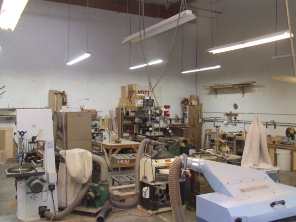

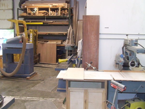

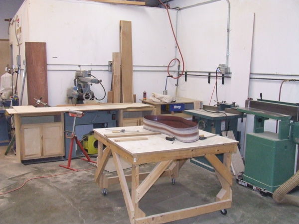

I'll try to come up with a sketch-up with the current lay out. As you can see by the pics things are a little tight. Storage is one of the bigger problems. I'm thinking pallet style racks may help.

Good luck!I agree with Lou C. on the need for a central dust system. Looked like you have a bunch of individual collectors taking up space.
Mathewson, How about a more piped in dust collection system? Oneida makes a nice cyclone. Thats if the budget warrants it. My question is: Is your table for the radial armsaw long enough for you? I'm thinking of redoing mine. You may have alot of machines clustered in the middle of the room. It may work for you. Good luck on the new move.

Funny thing is I had a large central dust collector and was going to have the dust drop into a dumpster outside but the landlord wouldn't allow a hole in the wall. To set it up inside would have made things even tighter. Got rid of it only last month. Maybe I'll look at a smaller one.I got the radial arm saw for doing bookcases but it hasn't been used in a long time. In fact it is one of the things voted on to go. The table was long enough for what it was used for.
Give the landlord a deposit to cover the cost to repair the hole if you should leave. A dust collector outside would be a huge improvement.
I would also get some tall heavy duty shelves/racks to utilize that high ceiling and forklift.

For my shop, the jointer is parallel to and right beside the planer, each faciing in the opposite direction. The table saw is nearby.
I believe it's easiest to have those machines out in the middle of the room, but only if you have underground electrical wiring. Your pictures show wires across the floor and that would seem to be a significant obstacle and liability when handling large pieces.
Conversely, the shaper, drill press and radial arm saw/mitre saw can all be pushed up against a wall.
And the single biggest improvement for you, it would appear, is a system of overhead ducts tied to a single dust collector, preferably away from the other machines.
