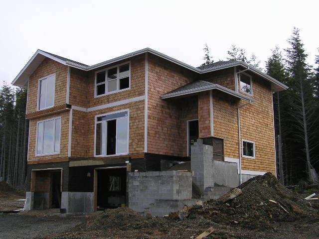

i have had that problem with cedar shingles(15" long 5-6 inch exposure) for sidwalls not roofs.. bleeding to the face of the shingles,leaving a water stained look ...i believe this has been caused by wet tar paper...when the sun hits tar paper it dries out and lays nice and flat...when its damp out the 15# paper wrinkels ...i have never seen breather boards put behind cedar sidwall shingles..here in the pacific north west ...of corse i havent been around that long either..i want to use that plastic mesh product they make...the stuff holds the shinglesof the paper like a quarter inch.. but the spec homes i side for folks claim the material is not in the budjet

Nice looking siding job. Is that Shakertown panels, or individual shingles, or...?
Where are you in the Pacific NW?Who's the cat that won't cop out, when there's danger all about?
http://www.asmallwoodworkingcompany.com
ive seen that too..water stains on plywood..felt does keep the oil in the shingles but if i hand shingles in the rain and the paper is alittle wet the shingles seem to water stain themself i think ...ive had shingles to that?im in gearhart...on the coastthose are all hand hung one at a time by myself -lost my worker to school-thanks
