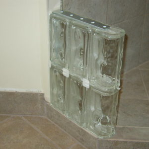

Tomorrow I will begin laying up glass block that will enclose my shower stall. I’ve never done this before. Any tips or caveats before I proceed? I’m planning on what Pittsburgh Corning calls their “Mortar II” method. The first part I construct will be a free standing wall 80″ (ten courses) high, with a 90 degree angle bracket at the top (see pics) as a reinforcement. The instructions call for panel anchors every other course. Would placing them every course make things much better? This wall will be the jam side of the enclosure.

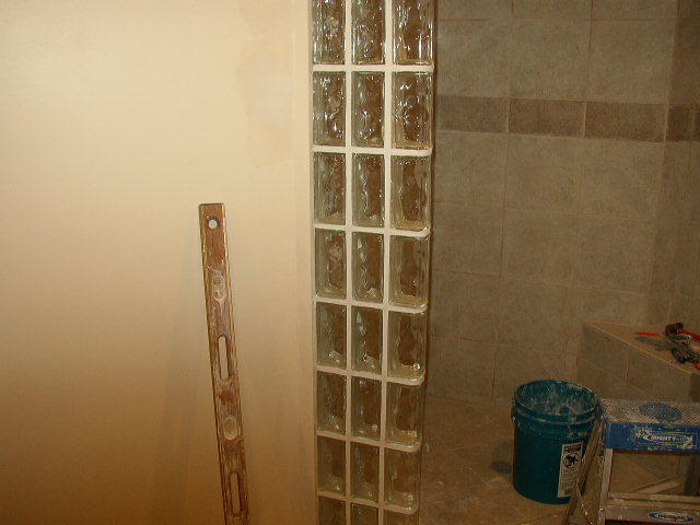

    1. WorkshopJon | May 11, 2003 04:49am | #9
      CAG,
      Geez, you know how I feel about posting pics. So here is where I'm at now.
      1. CAGIV | May 11, 2003 05:02am | #10
        Looken Good.Never be afraid to try something new. Remember, amateurs built the ark, Professional build the Titanic.
