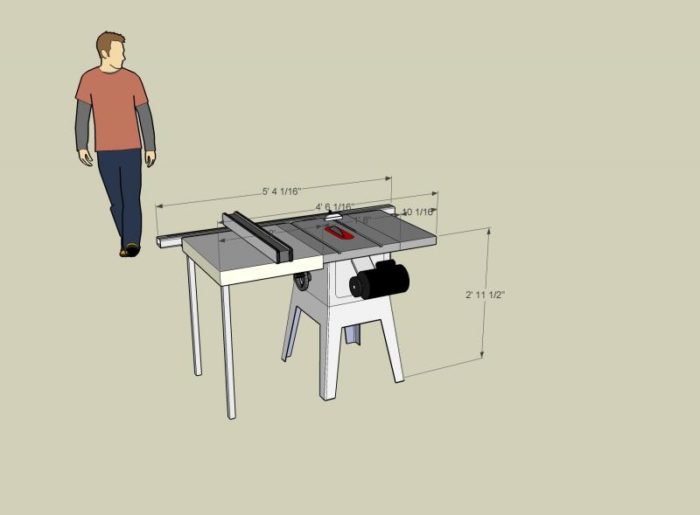

  I would like to plan the layout for my new shop  I’ve seen a layout program at the Grizzley Tool site but I want to layout the individual pieces in AutoCAD.  Does anyone know of CAD blocks that are avilable for common shop/woodworking equipment?

    Are you familiar with Sketchup?    http://sketchup.google.com/
    It's free becoming more and more popular.
    They have a huge, free library of equipment. Even if you don't want to use Sketchup for you layout, you may still be able to export the equipment to AutoCAD

      Thanks for the input.  I am exploring the Sketchup models online.  Several folks have uploaded their shop layouts with similar equipment to mine.  I haven't figured out how to export them into AutoCAD yet - except as a jpg or tiff image.  I would rather have them in a CAD format for editing.
      I wonder if Delta, Powermatic, Jet... have libraries of their machines for downloading?  The Delta website has plans for woodworkers, but I didn't see any drawings of their equipment.  Seems like there would be a need for these in their customer base.  I haven't been able to find any 2D or 3D CAD models (except for the Unisaw - 2D only).
      I use AutoCAD in my work so if I have to create them from scratch, I will, but I don't want to re-invent the wheel, you know?
      1. JMadson | Mar 07, 2008 07:04am | #3
        Sketchup has a pro version (not cheap) that will export your whole drawing to AutoCAD. I believe you can get it on a trial basis though.
        if so, download the trial version of the pro-sketchup, get all the tool drawings you want and then finish it in AutoCAD.
        Give sketchup a try too, you might be surprised how well it works.

    Try this link. It has lots of sketchup tool models.
    -h
    http://www.yda-online.com/shopmodels.htm
