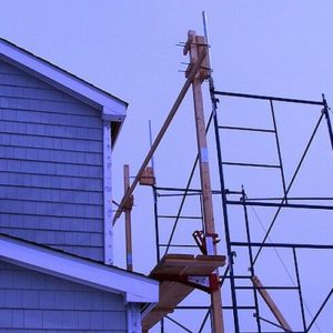

Would OSHA approve this setup?
caveman | Posted in General Discussion on March 7, 2005 07:25am
The pump jack pole on the left end is supported by the scaffold. No upper bracket is used.
Would any of you guys approve of this and would you work off this setup?
Would OSHA approve this?…I’m curious

    hmmm...i might, IF that scaffolding was also guyed off in other direction.... don't think I'd send a hired hand up there.
    Don't use scaffolding anymore anyhow -- use a lift.

      Which other direction?
      I used 2 guywires in the rear and with the cross bracing, it's solid.

    I'd say you have a shot at OSHA approving it if you were harnessed and tied off.  That's just a guess though.
    As far as working off of it.... looks like something I'd try.  Would I send an employee up there... depends on how it felt.  I'd have to have a better look at it and walk it to know for sure how I felt about it.

      caveman | Mar 08, 2005 01:45am | #13
      Thanks for the replies. I was curious if OSHA would allow it and what some of you pro's would have to say about it. I've never seen it done by anyone, and I just came up with the idea myself.
      This is the second time I've used this type of set up. The first time, the scaffold was used to support the 2 center jack poles on the other gable end of the house. The reason being was to eliminate mounting the standoff brackets on the siding(which I was replacing)and still reach the 30' peak. Plus...the brackets on the 2 end poles were attached to roof brackets. This allowed full unobstructed access to the soffits and rake boards, all of which I replaced.

    I'd like you to tell us why that left pole is so far...........left!
    I'm assuming that it was put there to work on the shed roof portion of the structure, but then, couldn't it have been moved over??
    I don't think I'd have a big problem with it, but between my son and I, we are only about 300# total!

      2 reasons why I did it this way...
      First...the bulkhead doors for the basement are located right where I would like to have put the pole. When I initially did the siding job, I built a platform above the doors and placed the jack pole on top of that. Worked fine, but I couldn't use the basement door for quite a while...like over a year...I'm a little slow<G>  With the scaffold set up where it is now, I can still open the doors.
      Second...by using the scaffold this time, I have a solid base to set up a 20' plank to access the upper gable wall above the shed roof. When I did the siding the first time, one end of the 20' plank was resting on a ladder against the chimney and the other end resting on the outer end of the planks from the pump jacks behind the house. Sort of like a cantilever effect. It worked OK but was a little hairy. So this time with the pole mounted further to the left, the 20' plank will end up on the inside of the pole instead of on the outside. Hopefully I explained that so you would understand it.
      In case you ask...this current job is what I think you guys call a 'call back'. I have to replace about 10 sq of siding that I had already installed. Defective product...time and materials is on the manufactures dime, but I also have to correct my own errors. The pictures don't really show it, but I made a few mistakes.

    I think the only thing OSHA would disaprove of are no guard rails.
    Guard rails not only make it super sage but also serve as a work bench so why not?
    Other than that its looks perfectly safe to me.

    OSHA would probably not allow this setup...The standards state that you must use the components of one system by one manufacturer. You are not allowed to mix components..

        don't quote me to the osha inspector.. but i think you can work on it.. as long as no one else is
        as for the staging..it looks like the kind of mickey mouse thing i would have dreamed up twenty years ago...
        now... we either stage it right or foggeddaboutit
        so  "A" for innovation
        but "D"  for safety Mike Smith Rhode Island : Design / Build / Repair / Restore

          all right  .. all right..
          i took another look.. i like the double planks
          i like the guy wires... the  U-clamps... the solid braces in one direction and the guy wires in the other..
          to me .. it's a red flag.. it'll draw osha inspectors like flys to sh------ugar
          and you spent too much time building it..
          next time think about renting a lift

            Hammer is right, Caveman. This is so far off of what OSHA would allow it hurts to think about it. OSHA inspectors love going to a work site and seeing wood scaffolding, because it is almost never made with scaffold grade wood. After that no matter how well made or sturdy it is, you are in violation. I always tell my clients if you have to wonder if it is in violation, it probably is.

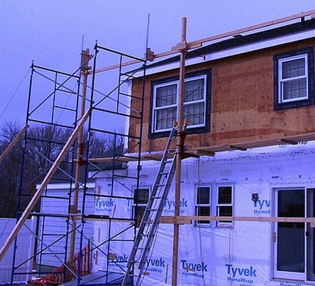

    You used Tyvek ???
    OSHA aughtta shoot you !

      IMERC | Mar 08, 2005 01:14am | #11
      what's plan "B"???
      cant felt under that type of siding he's using...
      Mfgr says not only no but hell no....

  8. blue_eyed_devil | Mar 08, 2005 03:40am | #23
    Caveman, I won't comment about whether this is osha approved since I don't have a clue.
    I am curious though, why you didn't just skip the pump jack and just lay the planks on and outrigger on the scaffold, or just set them on one of the scaffold rails?
    Even if this setup is osha approved, it's a situation that my tagline addresses.

      caveman | Mar 08, 2005 05:21am | #28
      If I used the scaffold rails to set the planks on, then everytime I needed to raise or lower the other jacks, I'd have to hump those planks up and down the scaffold. Double 16' 2x12's aren't exactly light...and I'm sure you already know that. ;) The way it's set up now, I can move the 40' of planks up and down using just the jacks.
      It's not like I have to raise and lower it a million times, but there are times that I need to. Besides all the demo work, it works perfectly when the time comes to haul back up 2--20' pieces of wrap for the fascia, without damaging them. Sadly, I have to replace them again too.
      1. blue_eyed_devil | Mar 08, 2005 04:29pm | #31
        Caveman, I'm not seeing the need for you to move the entire 40' scaffold walkway up and down.
        I'd move the fixed scaffold in closer and work off it direct using standard sized planks. I'd then bridge between the walk plank set up on the pumpjacks with a shorty...about a 7' plank if my eyes are correct. Using that setup, when you decided to adjust your height, you'd have to loosen up a 7' plank, adjust the pumpjacks, raise the standard plank, then re-lay the 7' plank. I'm guessing that fooling around with that 7' plank would add about 35 seconds each time you move.
        There isn't anyway I could justify taking all the time to do all that scaffold boogerin'...

          caveman | Mar 09, 2005 06:41am | #40
          Oh, I guess I misunderstood you.
          Yes I can see that your suggestion would also work, and alot less "booogerin" too LOL
          Plus your way would have let me set the poles at a 10' spacing. But doing it the way I did, also gives me much more piece of mind when I have to tackle the upper gable wall around the corner. I would feel much safer by resting the 20' plank...to access the peak of the gable wall...on all the mass of the jack planks, than just a couple planks set on the scaffold. At 20' up, the visual perception I get of that 20 ftr being supported by a couple 12 ft'rs on the scaffold is a little too queasy.
          FWIW...I doubt it really matters, but the spacing of my pipe scaffold poles is just shy of 10' and not the standard 7'or 8'(?). I made the cross braces myself, to accommodate the jack pole spacing I needed when I did the gable wall on the other end of the house.

    OSHA would require, back rails, toe boards, end rails, no walk zone below or nets, approved planks, additional brackets at mid span on the poles, pole foot anchors, mending plates at the joints on the poles, the poles must be free from checks, dead knots, spike knots, splits, etc. two sets of X bracing on the poles and that's just for starters. They will require that you have your written fall protection plan on hand. You will have to have written records of your safety training sessions. A qualified person has to inspect the scaffold at the beginning of every shift, again a written record must be kept.
    I wouldn't even have a guess as to how they might look at the rig with the pipe staging. Your butt is already so far in the sling it probably wouldn't matter. If there is one thing you can do that will really tick them off, it is ignoring OSHA standards. As long as you can show that you have been making serious attempts to understand and comply with the rules, they will work with you. With the picture you have shown, it is evident you don't understand fall protection compliance. It's been around since the early 90's so you haven't any logical excuse. They will most certainly fine you with that set up. Once upon a time that would have seemed like a super highway to work on. Today it is illegal.
    There's nothing quite like the joy of reading OSHA standards. They have tried to put them in easy to understand language but things are complicated. There are tons of different scaffolds for all types of work. The link below has some good information. The section on pump jacks is just about half way down the long page. If you are working in a visible area you'd be smart to do your homework.
    http://www.osha.gov/pls/oshaweb/owadisp.show_document?p_table=FEDERAL_REGISTER&p_id=13573

      1. SantaCruzBluz | Mar 09, 2005 06:10am | #38
        Caveman, I have no doubt OSHA would shut your scaffold down the minute they saw it. I don't think scaffolding was designed to support pump jack poles lashed to them, and a load that is pulling them to one side. But I'd work on it. Very few of the scaffolds I work on every day would be approved by OSHA.

          caveman | Mar 09, 2005 06:56am | #43
          Well based on the majority here, it appears that OSHA would throw the book at me.
          But since you and several others say you would still work on it, I'll sleep better<G>
          Thanks for the vote of confidence...

            BTW...how much flex is in the 24' aluma pole? Do those poles require cross bracing?
            dieselpig | Mar 10, 2005 05:19am | #61
            Dude... I'd chill.  I can't say what's good for you cuz my lawyer would hang me.  But, I'd do cart wheels on that set up.  I wouldn't load it up with 3 sq of shingles or anything, but for for siding... I'd feel safe.
            Now that's for me.  If you're as nervous as you seem to be, maybe you oughta move the poles in a bit.  You just might have an accident if your head isn't where it's supposed to be while you're up there working.

            caveman | Mar 10, 2005 05:42am | #66
            Thanks diesel, I've followed many of your threads and I also know you recently bought a lift. So I'm sure you can relate to my concern. Maybe I do need to chill, but after listening to you guys and using my common sense...I do have doubts now.
            One other fact that I didn't mention was the 2 poles on the far right initially had quite a bit of wobble to them when I was about 15' up. I'm talking in and out, not left and right, when I walked on them. I just strapped them to the house wall at about 6' from grade and solved that. When the siding is put back on, I'll lose the straps and just back brace them like I did with the scaffold. The 2 poles on the left side don't wobble and no additional bracing was done. Could be because of the close proximity of the scaffold, I don't know.

        2. MikeSmith | Mar 09, 2005 01:43pm | #49
          hammer... it is my understanding that osha set the 10' limit on wooden pump poles because of the strength rating of the poles... not the planks
          the 10 ' limit  on wod is onr of th main reasons we switched to alum-a-poleMike Smith Rhode Island : Design / Build / Repair / Restore
            caveman | Mar 10, 2005 03:58am | #54
            Mike, you really got me thinking now!...
            Am I correct in assuming that the 10' limit for wood poles is because any increase in the span equals increased platform weight/load on the poles? Does backbracing, against the direction of the load on the poles, help offset that extra load and to what extent? My knowledge about the stress point of lumber is limited...in fact almost non existent.
            The reason I ask...when I originally did this siding job on the back wall, the pole spacing was, IIRC about 10 or 11'. In fact I'm going to measure it this weekend, since I know exactly where the poles were. When I did the other gable end of the house, the poles were 10' OC exactly. Both times, I never noticed any flex in the planks...and I'm 6'2 230#. Now with the 13' spacing, I noticed the flex. The center planks are fine, but the outer ones DO flex! I added 2x4 blocking under them, but that was just to tie both 2x12's together. It also stiffened the planks a little, but not enough for me to be comfortable. After clamping the ends of the center planks to the outer planks, the flex was no longer an issue. Now I can walk end to end and 'feel' safe.
            Since I still have to spend a considerable amount of time working off this staging, now I'm a little concerned. The wooden poles and planks, even the "mickey mouse" scaffold deal doesn't phase me. I've spent many many hrs on them and feel safe. But the flex and 13' spacing issues are now bothering me. Mostly because of what I read from the OSHA reg's and what you said. If I add 3 or 4 16' 2x4's under the outer planks, that should stiffen them up. But more weight/load on the poles too! Maybe just continue with using the clamps??
            What would you do if you were in my shoes???
            I really don't want to shell out the coin for aluma poles, but I sure as he!! don't want to go 'skydiving' again...

          2. MikeSmith | Mar 10, 2005 04:33am | #57
            cave... when we used to use pump jacks. we used 2x10 rough spruce staging planks.. they were not rated .. it's just what everyone used
            they were 16' long  ( still are.. you  can still get rough spruce 2x10  staging planks )
            anyways.. we'd set our poles at  14'  and double plank .. just like you.. only we'd tie them with  1/2"   20x20 pcs of ply.. with 5  ( 8d )  nails in each pland..
             the theory was ... if one plank broke... you'd buy enough time to get off the other one
            i think the 10' limit has more to do with the poles.. if you load the poles . thye can find a weakness  and blow out.. ( snap ! )
             there was a bad accident in town two years ago  with pump jacks.. one of the poles blew   and dumped 3 guys onto the rocks
            that's my story and i'm stickin to it
            caveman | Mar 10, 2005 05:05am | #59
            The poles are my concern now, sorry if my ramble didn't clarify it. I've only used doug fir for poles and planks and never had a problem. The first set I tossed, since they had been out in the weather for quite a few yrs. What I have now is all new stock that I hand picked myself....course I'm no expert in wood either.
            Since you worked with poles 14' OC (for a number of yrs I presume), do you think my set up will hold up with just me working on it? I realize sh!t happens, and NO WAY would I put you on the spot to give me a definitive answer. But being an experienced pro that you are, is the 13'OC at the low end or high end of overstressing my poles???
            You got me nervous now...I have no idea how much stress is on my poles either
            Help me out MIKE, or anyone else...I'm SERIOUS!!
            caveman | Mar 10, 2005 05:23am | #62
            So what do you think Imerc
            give me your honest opinion...you think my 13'OC poles overstressed??
            I'm really starting to think I need the aluma poles and that's gonna hurt...$$$$$ ouch
          5. MikeSmith | Mar 10, 2005 05:30am | #63
            cave.. DF ?  finest kind.. only thing better might be sitka spruce....
             i think you're fine..
            i'd have X-brace on them .. and i'd tie them to the wall  about half-way upMike Smith Rhode Island : Design / Build / Repair / Restore
            caveman | Mar 10, 2005 06:04am | #67
            Ok, that sounds better. I thought DF was top shelf, but didn't know if it was suitable for jack poles.
            What does the X brace do that my horizontile braces don't? One of the reason I used them like I did was to help keep the poles straight and not twist.
            I know you guys are reluctant to post something here that could make you liable and I respect that. So I'll post it here that I WON"T HOLD ANYONE RESPONSIBLE other than myself if the staging fails. Remember, almost everyone here already told me this set up would flunk OSHA's requirements...even if I am just a HO.
            Now I feel better, even better now that diesel said he would do cartwheels. But as for Imerc, Goldhiller and myself on it at the same time??...the juries still out  ;)
            Thanks Mike...I do appreciate you thoughts
            IMERC | Mar 10, 2005 05:34am | #65
            like I said...
            I'd work on that and I'd get Golhiller up there with the two of us...
            WOW!!!   What a Ride!
            caveman | Mar 10, 2005 06:13am | #68

          9. SantaCruzBluz | Mar 10, 2005 07:03am | #69
            I can't see any braces running from the poles to the wall in the picture. I know you don't want to puncture the housewrap, and you won't want holes in your siding, but if you can run a few braces to the wall, that would make the poles much more rigid. You could also run some braces straight out in back of the pole to a stake drove in the ground.Your horizontal braces are doing the same job in one direction, but what is doing it in the other direction? Anytime I use pump jacks, I run braces every five or six feet up the length of the pole, to the house, two braces in each spot, running at an angle to the house.
            Allen in Santa Cruz
          10. User avater
            caveman | Mar 10, 2005 08:12am | #70
            There are braces to the wall on the 2 poles on the right, about 6' from grade. The pic doesn't show them. Now that the demo is done and the new Tyveck is done upstairs, I'll remove those 2 wall braces and back brace the 2 poles to stakes in the ground. Then I'll put up the new Tyveck and siding on the lower section and work my way back up. I believe the back braces should be sufficient. They work like a charm for the scaffold, it doesn't budge an inch, fore and aft or left and right. The siding is vinyl shingles and once it's up, it'd be tough to tie into the wall without causing any damage to them. I suppose I could remove a section of the siding to connect a brace, and replace it when I'm done, but that would be a PITA.
            >>Your horizontal braces are doing the same job in one direction, but what is doing it in the other direction?<<
            I'm not sure what other direction you mean. As in perpindicular to the house?
            The 2 sets of horizontal braces tie into the scaffold for increased stability and also limit any twisting of the poles over time. What do X braces do that my horizontal braces don't?
          11. MikeSmith | Mar 10, 2005 02:21pm | #71
            cave.. the horizontal braces allow the entrie scafffold to sway in unison
            X-braces will not allow that movement
          12. User avater
            caveman | Mar 12, 2005 09:15pm | #73
            Mike
            That much I understand. The scaffold use the X braces for that very reason.
            With my set up, I am relying on the X braces of the scaffold to prevent any lateral movement of the jack poles, since the poles are attached in 5 places to the scaffold. Here's a couple more pics showing the connections. I would think the 10' spacing of the pipe scaffold offers enough of a foot print to keep from tipping. I've actually tried to tip the scaffold...yeah I'm nuts sometimes<g>...by climbing up to the top, on the outside of it and shaking the shid out of it. Rock solid!!
            Sorry if I appear to be beating this dead horse over and over. I just got a little paranoid after reading what you said about the poles snapping.
            Next time I ask for anyones approval here, I won't use that term. I wasn't asking for a stamp or sign off, just some proffesional opinions. I just recently learned that asking for and receiving approval here, could lead to some serious liabilities if something happened.
