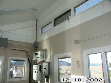

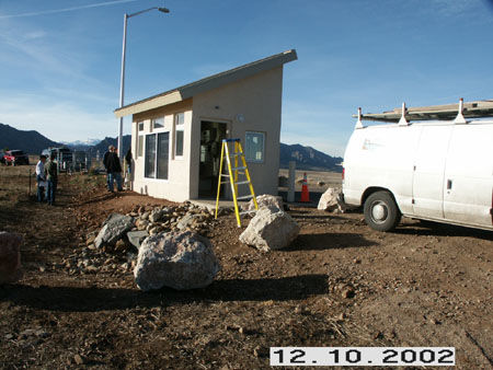

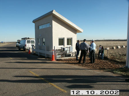

Unlike the Oregon house, the project I was part of was a small guard shack for the lab's wind research campus north of the old Rocky Flats weapons plant. What started out as a good idea to provide a point of control for entry into the site became secondary once certain researchers bent the ear of executive management to turn it into a net-zero energy usage research project.
At the time I was working on this shack, which was about 4-years ago, the plan was for it to be manned 24/7 by preferably 2 guards. This shack has an external footprint of 16' x 10', and due to the thickness of the precast concrete walls with extruded polystyrene foam insulation and synthetic stucco finish, the net usable inside space amounted to less than two of NREL's standard 9' x 8' cubicles. There are more Pella triple pane wood windows in this shack than my Mother's 850 square foot house. Electrical power is primarily provided by PV panels on the roof, along with the ability to easily add a small wind turbine if power demands require it. The shack has three thermostats inside, along with the storage battery and inverter equipment. Our team wanted to put the battery and inverter equipment outside in a weather proof enclosure to give the guards more space inside; but we were over ruled by the researchers. Heat is provided by a trombe wall on the south side and an electric resistance heater as backup.
So in less than 140 square feet of space, the following items were jammed in there: 2 guards, desk space, aisle space for a visitor or two to get badges, battery & inverter equipment, small refrigerator and microwave. Am I missing something? Yep, there is no permanent bathroom for the guards. The guards get a port-a-potty as the nearest restroom is literally 1/2 mile away at the main office building on the campus.
An electrical engineer I was working with at the time calculated the payback on this shack was about 300-years. When I left NREL, the cost of this shack was approaching $1,000 to $1,200 a square foot. Granted, NREL is always happy to pay way more than the going rate for certain construction services, and I have no doubt this factored in to the high dollar cost of this shack that suffered serious mission creep.
Your guess is as good as mine as to what or how the guard is being used for now, or what changes have been done to it since I left NREL.
