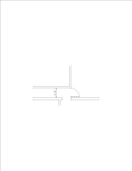

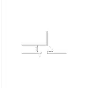

Customer, small office bldg, wants to add a door to a cased opening.  See attached sketch.  The opng is exactly 32″ wide.  I hesitate to add a door, because the new opng will be rather narrow.  Don’t think it will pass code either.  The wall at the bottom is very thick, 10″ I think.  Ideas?

    Is the door only for privacy, or an entrance which requires a lock?
    What about a sliding door into the wall at the top of the drawing?

      Renovating space for a beauty salon, and this will be the managers office.  Wants to be able to lock up the office at night, privacy for counseling, etc.

        What is that thicker wall on the bottom of the opening made of?
        And where does it go to?

  2. FastEddie1 | Feb 07, 2003 01:02am | #4
    Might work...I'll offer both that and the surface-applied pocket door.  No one knows why the wall is thicker.  Second floor, non-load bearing.  The other walls are 'normal' thickness, all are wood 2x4 w/ 5/8 gwb.
    1. CAGIV | Feb 07, 2003 01:05am | #5
      Possibly a vent stack or duct work of some sort for something in the thicker wall?

    1. FastEddie1 | Feb 07, 2003 01:53am | #7
      I drew it in Autocad LT (still a .dwg file), saved it, opened MS Publisher (came on the computer) and imported the drawing, then saved it as a jpg.  That's why there is a lot of white space around it.  I think other programs will also do the conversion.

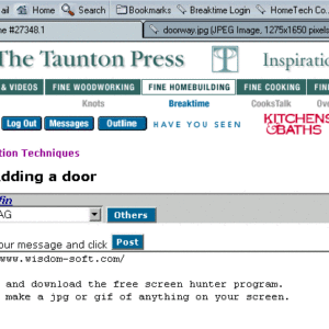

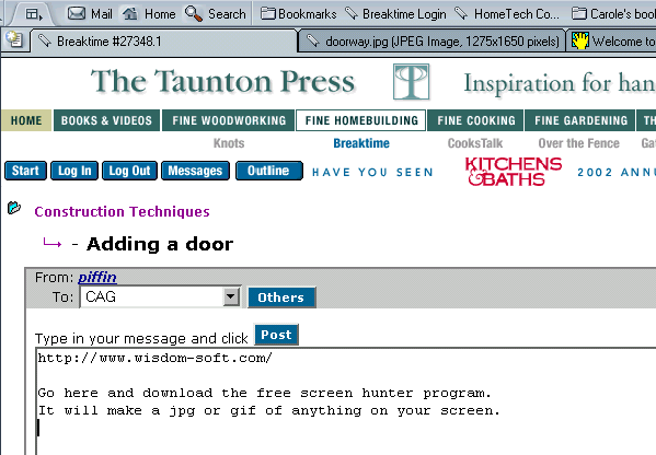

        1. Piffin | Feb 07, 2003 03:36am | #9
          http://www.wisdom-soft.com/
          Go here and download the free screen hunter program.
          It will make a jpg or gif of anything on your screen.
          See the attachment for a sample
