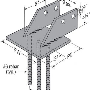

In above video at 4’50”, a post base is used to attach beam to concrete footing directly. This is a low deck so there is no enough space for a post. The question is a post base sold in Home Depot or Lowe’s is usually 4×4, which is 3.5 inch wide. Two 2×10 beam is 3 inch. There is half inch gap. Where can I find post base of 3 inch width? Thanks!

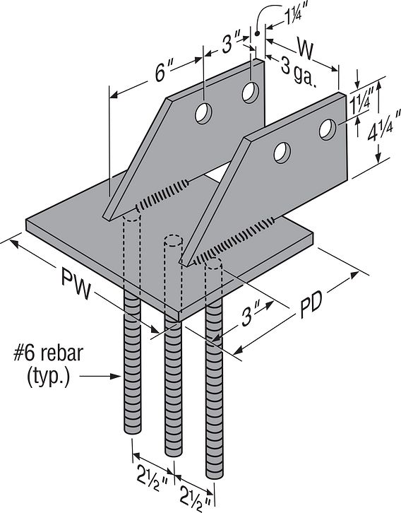

      https://www.strongtie.com/girderhangersbeamseats_concreteconnectorsandanchors/glb_seat/p/glb
      This is the closest one I found.
      1. calvin | Jul 02, 2021 05:41am | #6
        https://embed.widencdn.net/img/ssttoolbox/uvrwzozmmv/284px@2x/HGLB_callout.jpeg?keep=c&crop=0&quality=80&u=cjmyin
        3-1/4”, washer the difference?

          1. calvin | Jul 02, 2021 04:02pm | #12
            Here’s another detail oriented not at the box store that comes 3-1/4 that can easily capture 2 treated 2x’s. And it looks damn nice.
