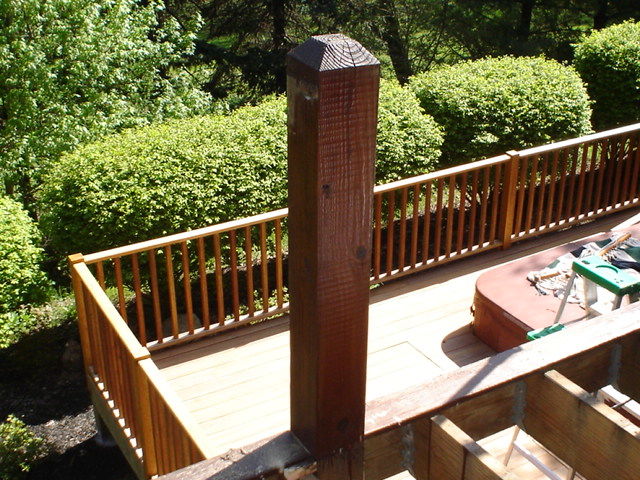

I’m remodeling a deck, keeping the old frame, but removing the old CCA 5/4″ decking and handrails.  I’m running new 5/4″ mahogany decking, and new mahogany railings.  It’s on the second story.
The existing 6×6 posts run all the way to the ground, and are notched for the rim joist.  The railing posts are very solid, and I’d prefer to use them, rather than bolting 4×4’s to the outside of the rim joist.  I really don’t want to cut them off at the frame, but if I have to I will.  The question is how the reface the existing posts.
I thought about ripping 1 1/4″ off all four sides of the existing posts, and covering it with decking.  My concerns are 1) That doesn’t leave much of a post for a solid railing. 2) It will expose the untreated center section of the 6×6, which may lead to problems down the road.
My other thought was resawing some of the decking to 1/8″, and basically laminating it to the posts.  My concern here is the durability of an 1/8″ skin exposed to the elements.
The posts will eventually be capped with a copper top to cover the end grain.
The sky is the limit as far as ideas.  Full wood shop to use, and money is no concern.
Thoughts?

  2. DanH | Apr 27, 2006 10:27pm | #2
    Sand them lightly (wear dust mask) and then paint them. Any sort of veneer you put on them will attract rot.

    1. dustinf | Apr 28, 2006 03:38am | #5
      Yeah, I'm thinking the sleeve is the only way to go.  Probably cut the existing 6x6 down, and wrap it with the 1x.  Cap with copper, and call it a day.

    PeterJ | Apr 28, 2006 04:19am | #6
    Hiya Dustin, if you want to make a good sized job out of it you could rout a rabbet on the corners and put a copper skin with trex or cedar corners screwed on.

    jarhead | Apr 28, 2006 12:24pm | #9
                   What about using an electric hand plane to remove about a 1/16 9maybe less) of material around the posts, then stain to match new wood being installed?
