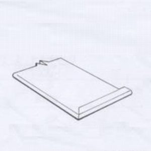

I’m looking for a reliable way to cut stair treads on an open staircase.  The stair tread will look like the picture below — that is, the tread will be cut to receive a return so that no end grain is showing.
I’ve thought of cutting the tread with a sliding miter saw, but it seems like I would have to then clean out the corner with a hand saw or jig saw.  Is there a better way?

    Rout the miter as a radius, then round the end of the return with a template to match...
    Stan Foster showed how in one of his many excellent learning type posts.
    zak | Jun 25, 2007 03:18am | #2
    Sphere's talking about a swoop miter- I've seen it here, but haven't gotten the chance to try it yet.  The two sides of the template are cut out of one piece of plexiglass or whatever your template is made out of- it's a straight line with a radiused curve from 0 to 45 degrees, so that a bearing guide router bit can follow it.
    I typically cut the miter on stair treads with a circular saw and edge guide, all the treads at once.  Then I cut the square cut with a scms, and finish with a handsaw.

    1. Piffin | Jun 25, 2007 03:36am | #3
      Me too, except when I don't. Sometimes I use a tablesaw with the blade up high for the main cut which reduces how much I have to finish by hand. I have done them with a hand held circ saw for first cuts too.I use a slot bit on router to insert a spline and just glue at the miter end
      1. Ragnar17 | Jun 25, 2007 04:54am | #4
        If using a table saw, couldn't you overcut the notch a bit (and therefore eliminate the need to hand saw)?  The overcut portion would be on the underside and therefore not visible.  Or are you worried about potentially weakening the tread?

  3. DougU | Jun 25, 2007 05:57am | #6
    I like the look of the stair treads that Stan Foster does with the radiused cut but not everybody does.
    If you want the traditional look with the miter like your picture shows you can cut them with the circular saw or sliding compond saw. You have to finish the cut up with a hand saw and maybe pare a little away with a sharp chisel, really not all that difficult.
    I like the idea of the table saw cut, build yourself a nice sled to hold the tread and make sure your blade is cranked up as high as possible to shorten the amount of back cut on the underside. You can build a sled to make both cuts with the table saw and completely eliminate the need for any other cuts.
    1. Ragnar17 | Jun 25, 2007 06:47am | #8
      I think Stan has a good idea with the router-cut treads.  Unfortunately, I'm a pretty traditional guy when it comes to millwork, so I'm going to try to see if I can't figure out an alternate solution.
      Between two 12" compound saws, a table saw, and a radial arm saw, I ought to be able to come up with something.  ;)

  5. Ragnar17 | Jun 27, 2007 01:32am | #13
    Here's an interesting gang-cut approach I found at another site:
    "Stack all the treads lining up the front edges perfectly and clamp them together. Using a straight edge and a circular saw set to 45% cut all the miters with the deck of the saw resting on the end of the treads (this works best if all the treads are stacked standing on end). Then finish the end cut with a sliding miter saw or circular saw with straight edge. Finish this cut with a hand saw."

          zak | Jun 27, 2007 05:09am | #19
          They have to be set on their long edge, unless you like holding your saw up- I don't.
          It works quite well.  Of course, there is the possibility of tear out on the top and end of the cut, so if you're using a splinter prone wood, tape the line, or score before you cut.
          I've also done stupid things like over cutting the straight cut, when the slide miter saw slid a bit too much.  Make sure you cut the miter end before you cut to length.zak

          2. Ragnar17 | Jun 28, 2007 06:54am | #23
            Zak,
            Well I tried the gang cut approach on the treads today -- it worked great!  Thanks for the tip.
            The only "problem" was that the tread depth was not very consistent; I put a straight edge across the noses and dinkered around until I got them all in a line.  But besides that, it was a snap.
