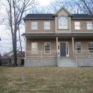

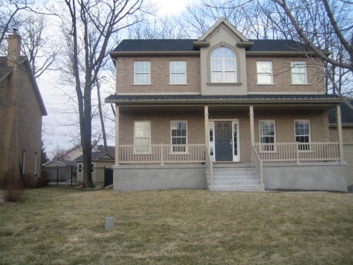

I’m just a do-it-yourselfer who is building two little retaining wall planters on either side of my front steps. My problem is that my yard is sloped but I want both walls to be level with each other when complete. The walls will not come past the stairs. I’m looking for an effective way to level both sides to one another, even though one side is significantly lower than the other. I’m attaching a photo to help illustrate what I’m talking about with the front of my house.

    Looks to me I would use the porch for reference, measure down the same on each side.

    As was previously mentioned, your porch looks level, measure down from it.
    Also, finished retaining wall height should look same from steps.
     Figure what you want for a finished retaining wall height and mark this on one side of  your step's foundation. Extend level line from this mark, back toward the porch foundation.
    Measure from this extended porch foundation line, up to  the underside of  visible  4 inch wide porch edge "banding" and record this measurement.  Consider how long you want retaining wall to be. At other end of porch, measure down from porch edge banding the same distance as  earlier recorded and make a mark. Now, chalk a line between these 2 points on the porch foundation wall.
    For second retaining wall layout, go to  the opposite end of the porch, and  measure down from porch edge banding at desired locations and again place your marks. Chalk line on this side as well. Check line height closest to steps by extending a level line out from porch foundation mark, back to the step foundation. This  new mark should be same height in relationship to steps as was your first , earlier mark when laying out the first retaining wall.
    Decide how far out you want to extend planter from porch foundation. On step foundation, mark a vertical line down off the original horizontal line, signifying the outside corner of your planter. Drive a stake in the ground just in front of this vertical foundation line. Top of stake should be even with top of original horizontal (height) line.  Measure out distance from porch foundation to this stake and record the measurement.  Measure out from opposite corner of porch foundation same distance and drive another stake. Use carpenter's level to make sure this stake is same height as the chalk mark on porch  foundation.
    Now run a stringline between stakes. Pull string line very taut. You can check for level using a mason's string level, or using a water level.  Mason's string level should suffice.
    Do same on other side of porch steps. These string lines are your guides for your walls finished height.     Walk back away from house and visibly "sight" both stringlines. If they look good, so will your wall. If something looks visibly wrong, go back and check your layout.
