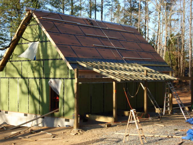

What would be the best way to attach a ledger board  that will be holding 2 X 6 rafters that span approx. 9′  (wrap around porch rafters) to the gable end wall? …The ledger will be placed approx. 26″ above the 2nd.floor rim joist….Gable end wall is 2 X 4 construction.
any suggestions will be appreciated.

    Is that sheathing sugar coated wood?  Plywood, OSB?  I haven't worked with it before.
    If it is wood here is what I would do,  use the ledger loks that have been reccomended.  Then for a little extra you could nail from the inside through the sheathing into the ledger with RS 2" nails.
    Just a little cheap insurance.

    1. Bpawb | Mar 02, 2007 05:10am | #35
      Is that sheathing sugar coated wood?  Plywood, OSB?  I haven't worked with it before."
      Its advantech Zip Wall System from Huber Woods
      Good idea  " nail from the inside thru sheathing"
      Thanks everyone, i ordered a bucket of 3 5/8" LedgerLoc's today
