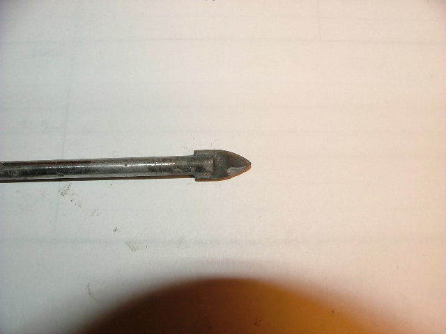

  1. RalphWicklund | Sep 16, 2005 08:45pm | #1
    I've never seen a requirement or recommendation to use cutting fluid with a tile bit.
    Are you sure you have a TILE bit?
    Look at the attached photo.
    You should make accurate hole locations before drilling, going so far as to drill the first hole and then placing your template or bracket back on the wall to verify the maked locations before drilling again.
    On tile you will need a break in the glaze to keep the bit from wandering around and making a hole where you DON'T want it. Some will use a nailset to break the glaze. I place the bit in the drill, place the point of the bit on my mark and strike the back of the drill sharply with the heel of my palm one time and generate the break in the glaze. No extra tools needed.
    Once started and through the glaze, most tile is rather soft so the bit goes quickly through and into the substrate. If you are lucky, you could hit a stud. If you do, stop drilling at the depth consistent with the length of the plastic anchor. Tap in the anchor (it seals the hole and takes up some slop) and use a longer screw so you bite into the stud beyond. With any other holes you will probably hit the void behind the tile and substrate. Tap in your anchors and use the recommended (or supplied) screws for the brackets.
    You don't have to worry about the torque. Use the variable speed function, about medium to start and you can speed it up if you want as the wide body of the drill passes the glaze.
    That ought to hold you.
    C'mon back.

      1. NRhodes | Sep 16, 2005 09:08pm | #3
        Yes  it looks just like that...   and I neglected to mention the package pictures had the punch pictured to make a starter spot..  (how I would describe the picture).
