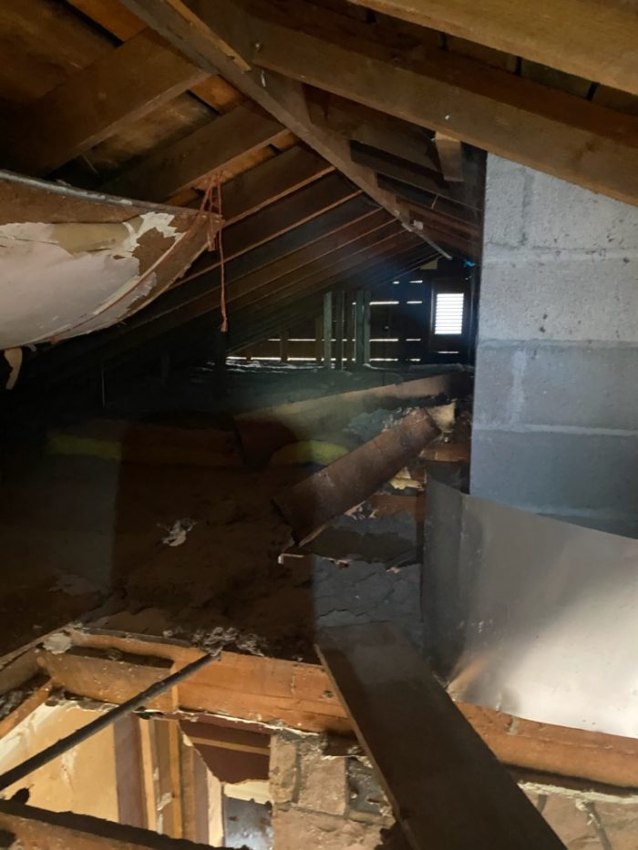

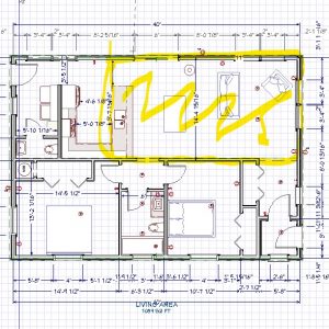

I want to open up a portion of the attic to the living space and remove some of the joists in that area to create a more open look to the rafters.   This is only on one side of the 14′ center wall.    I know I will need to beef up those joists that remain. I am trying to understand if I can remove every other for 4′ spacing between the open rafters or can I go as far as 8′ spacing without creating a structural issue.
The one photo shows the space I want to open, I realize I can’t remove all the joists without a ridge beam.   Don’t want to do that, very hard to get done due to the rural location.

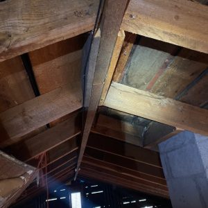

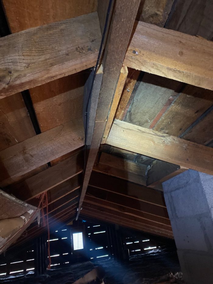

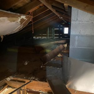

The other two are just some pictures of the structure.   The house is in the process of being stripped to the studs.
