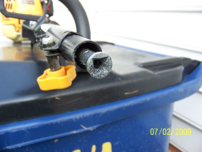

Cub Cadet gas string trimmer has a problem.  The motor runs fine, but the head does not spin.  Looks like the zinc socket has been wallowed out by a loose fitting driven shaft.  The lower shaft comes off so you can use a different head, like an edger.
I can buy a complete new upper shaft for about $45, so any fix will have to cost half that much or I will simply buy a new one.
I’m thinkimg about filling the socket with lead, inserting a section of square drive shaft to create a new recess.

      I thought lead might be soft, but I think it will only be about 1/16 thick.  JB would be easier to work with, maybe I'll try that first.  I was wondeing how to get the melted lead in the socket and keep it milten long enouygh to stick the shaft in place, and then how to keep it from sticking the whole thing together."Put your creed in your deed."   Emerson

        I see. Just use JB Weld, lead will waller out again too soon.  Coat the mating part w/lard, or vaseline to keep it from sticking.
        The orig. is probably magnesuim or a zinc alloy...maybe alum.

    I would think lead would be too soft. I would use Devcon, JBWeld or another steel epoxy.
