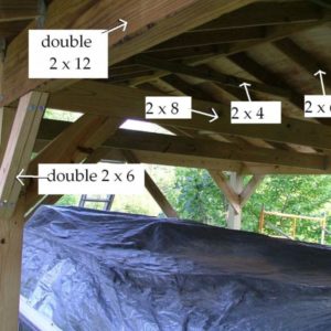

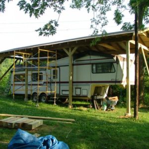

Hi all,
Just finished framing a large permanent shelter for a camper. (Building will be enclosed and become a workshop one day).
Problem is it sways pretty violently when I walk on it, or even push on it from the ground. (especially if I get a good rhythm going). I’m afraid to put the shingles on it (let alone snow and high winds) till I can stiffen it up.
I don’t want to obstruct the view from the camper windows with a bunch of framing if I can help it, and I’m wondering if I can use cables and turnbuckles.
Anyone have any suggestions?
Thanks in advance.
Kyle

    The 6X6s are unbraced for bout 12' or so.
    Unless you brace the roof to the bottom of the posts somehow it's gonna keep swaying.

        cables need to be paired in cross tension to do much for you. I'd also be worried that placing them very low would make for a chance to clothesline somebody and hurt them. i see another probably weak point. Are those kickers only held in place by one 1/2" lag each?
        Looks pretty, and neat work, but several toenails or screws would do a lot more for you to avoid movement in the joint. You could also try tightening all of them. I see this is PT lumber which shrinks daily for the first couple months, so that would cause a lot of slop in those joints in just a few days

            The angled boards that you have in the corners are also called knee braces or kickers.  Particularly the ones inside the building running from the column to the ceiling joists.
            You also need to add X bracing in at least one bay below the roof  at the ridge running down to the ceiling joists with horizontal brace/stiffener going from ceiling joist to ceiling joist.  The entire rafter system can transfer laterally in the direction of the ridge.  Happens all the time with unbraced trusses.  Its less common with rafters but can happen.
            If your columns are well anchored to the foundation piers you might not need a horizontal brace at the base of the columns in the braced bay or bays but you will probably need X or K bracing from that horizontal beam the rafters are sitting on, to the base of the columns.  If the columns are strong and stiff enough you might not have to go all the way to the column bases.
            Use forged eyes on the turn buckles and anchor points not bent eyes as the bent ones will straighten out.
            The more bracing you put in the smaller the sections of pieces or diameter of cables & rods can be.  Its beyond the scope of this forum to go into how to determined the number of braced bays you need or how to size the cables but those issues need to be addressed for safeties sake.

            What Jim said.   Those 45 degree 'braces' aren't enough to do much of anything.

            The diagonal brace you have is the kicker

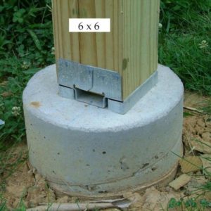

    Too late now, but imbedding the posts would have helped considerably.

           your knee braces (the diagonal double 2x6's)  need to be at least twice as long as they are now, 6 feet long would do. You should probably use 4x4's instead of 2x's and fasten them w/ carriage bolts running horizontal (not angled as the lags are now) through one 4x4, through the post and then through the other 4x4.
     You drill counter-sinks to accommodate the bolt head and a washer on one side and a washer and the nut on the other end, this locks the whole assembly together much better than what you have now, At the top of the brace you fasten them vertically into the bottom of the 2x12's (with the same counter sink technique) using lags, adding toenails, as Piffin mentioned, would help at this connection.
    The collar ties (horizontal 2x4's halfway up the rafters) should be 2x6's and sitting down on the beam the rafters sit on, they're doing no good that high up on the rafters.  You would clip the top corner of each collar tie to match the roof pitch so they fit under the sheathing and have them span from outside to outside of the beams. The 2x8's you have running between the beams are not needed  and just reduce your ceiling height.
    Diagonal bracing from the ridge to the top of the beam at each end would also help in stiffening the structure.
    You could also do the knee braces on the outside face of the posts and beam and through-bolt them using 2x8's,  although this is not as aesthetically pleasing as the 4x4 method, it will function structurally just as well with less material required (you can use the 2x8's you already have in the ceiling, if you fix the collar tie situation)

    your problem is at the base of the post I'd a put them post 3-4 ft in the ground. larger braces may help some but i doubt they cure it.turn buckle it. top to bottom opposing directions between each post.

    My reaction is to direct your attention to the bases of the columns rather than the tops and bracing. All the post/pedestal joints are acting like hinges, when they should be rigid.
    Since you are not about to reconstruct at thisstage, how about some buttressing braces outboard of the posts and double at the rear corners.
    Two examples to copy - airplane hangars and mansard style construction.

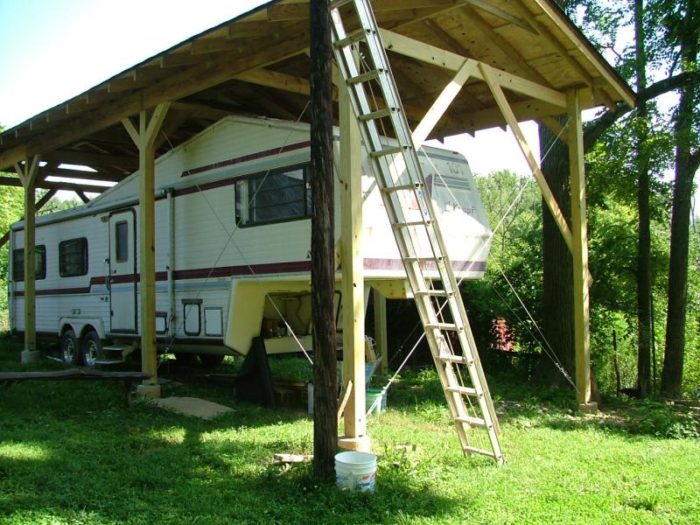

      Thanks to everyone for the information regarding my swaying structure.
      I ended up attaching some 1/4" cables diagonally between the posts and that made all the difference. An x on each of the long ends and two x's opposing each other on the taller end. I'm no longer concerned about heavy snow and wind taking it down. I'll cover them with some pipe insulation to help prevent serious injury when I have forgotten they're there and run into them.
      Many thanks again for all of the helpful opinions!

        I think I would put some rails on it so people don't walk or run into a wire.

        Are those cables attached to the kickers? That wouldn't be good.
        1. KylefromKy | Aug 14, 2009 09:56pm | #43
          No, they're attached just to the top and bottoms of the posts. Through bolted.

        I was saddened to see this turn ugly.  The solution works and I think your happy so its satisfactory.  What you built around here they would call a pole barn.  Those 6x6's would be rated for in ground use ( .6) I belive is the treatment rating and sunk preferably 1/3 into the ground 5- feet or so in your case. Compacted gravel for good drainage around the post
        That takes all the sway out from day one.  Thats my opinion done that way they are rock solid.  I realize you wouldn't be able to change that and without putting sheathing on those cables were the best option you could have come up with.  The weak point will always be connection to the sonna tube.

            Around here, Hawaii, direct burial is almost never done because of termites. Even when the lumber is PT. The only common exception is fence posts, which usually get destroyed 10 years later!
            Nice to see your cabling provided adequate shear resistance. You should look into installing (or reinstalling) the eyebolts as close to being in-line with the direction of the cables. Installing them straight into the posts and pulling them at a 45 degree angle will reduce their capacity by 50%.

          138. KylefromKy | Aug 23, 2009 02:19am | #213
            The cables did the trick. It's pretty stiff, now.
            Thanks.

            That is diag bracing in the roof structure. Maybe that is small enough that the plywood provides enough shear resistence, but keep in mind that with something open like this, you have a sail up there when the wind blows, so give another though to how it is tied down too.On permits - most of my life has been working in areas where none are required for structural, but it would be wise for you to check if they are required or not. Typical fines for non-compliance is $100/day and it is not uncommon to see a building razed because of non-compliance. if you are doing this professionally, the courts assume that you must adhere to minimal professional standards, so they could easily award your client remunerative damages plus penalties, meaning that you would be in debt for many years to come simply because of not checking ahead of time. That is similar to the point Joe was making rudely, that if a structure you build falls and hurts someone, YOU would be the one responsible for the costs at least. It is a principle as old as the oldest laws in the world - back in the days of Hammurabi and the Bible and the Egyptians if a builder erected something so as to allow it to fall and cause injury or death, he was to be put to death himself. I recall reading of a Chinese builder who was put in prison for the rest of his life for poor design.We are a bit more easy on folks in this country, but the principle has merit.
            Words to the wise.
          152. KylefromKy | Aug 23, 2009 01:56am | #211
            Sorry for the delay in my response, but thanks for your reply.
            I appreciate your concern and advice. The cables have done a great job stiffening the structure, but I'll look into adding some diagonal bracing in the roof just to be sure.
            As for liability, I'm building just for myself, not a client, but I appreciate the information just the same!
            "Argue for your limitations, and sure enough they're yours."

          Take it easy Joe.Not all of us are subject to permits and inspections.and we all have to start someplace
  7. Shoemaker1 | Aug 15, 2009 05:40pm | #62
    Well a can o' worms eh?
    I was at a Cottage designed by an archy. It was his first build. No permits needed.
    2 storey built on piers set into bedrock. It swayed like a old boat in high waves. Especially when two or 3 kids were screaming around. I mentioned this to the HO.
    She replied that it has always swayed and it drove her nuts but the arthcy said it was with in normal amounts. I used to work a a junior draftsman and she asked me what I would do?
    So I crawled under the cottage and saw there was no diagonals at all. So I grabbed a couple pieces of rope and tied off a couple spots. She noticed a slight improvment. So a couple days later her husband showed up and she was flapping around about how I helped the situation.
    Hubby went and got a bunch of SS aircraft cable anchors and misc hardware. He tied all the Floor joists to the piers with diagonals and now it was stiff.
    So don't feel bad even the guys with all the training make mistakes. Nothing like real experiance to make all those #s work.
