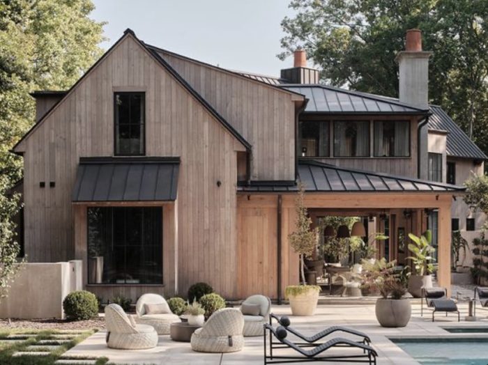

I’m looking to utilize vertical cladding for a new build, but don’t want to pay the premium for composite or thermally modified material like NuCedar or Accoya, etc. – both of which utilize a pretty straightforward install with board cuts at random lengths and staggered butt joint connections, all on top of a furred rain screen, of course. (Attached a reference image for design/aesthetic preference)
