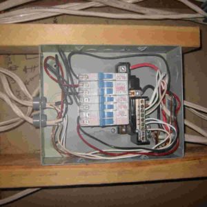

I need to add a 220 circuit to my cabin, but there is only 1 circuit slot left.  Is there anything I can do that is easier than replacing this panble with a bigger panel? Photo attached.

    Look at the label on the panel and see if it is rated for 8/16. That is 8 slots and 16 poles.
    If so you can replace the two single pole breakers (120 v) with a single tandem breaker.
    And you will have to move the 2 pole breakers around so that you have two open slots togther.
    That will get you 240.
    Not sure what you can do to get 220, other than a big autotransformer.

      Thats an FPE 8cct sub panel. Its already got the narrowest breakers FPE makes. In order to get another 220 cct out of it, it MUST be replaced with a larger panel, unless you are willing to "sub a sub" from this panel. (not advisable). It's also only rated for 60 amps, and without a main breaker, it is not allowed to be used for "service entrance" purposes.

    I agree with Bill. Also, considering your picture and the full-ness of the panel, I'd replace the panel. With the wall open as it is, it doesn't get any easier. Consider - you'll have room for future growth...

    replace the panel or add a small panel...

    If you're leaning towards replacing the panel at all, another benefit would be getting a main at the panel.  You don't seem to have one in there.
    That panel wouldn't pass code where I am for a couple different reasons.
    Pull the meter and replacing a small panel like that with a big one (that has a main breaker) would be cake.
