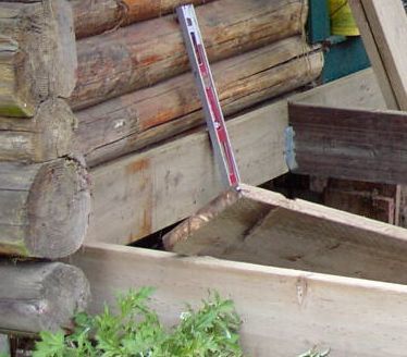

I’m looking to create a waterproof connection between a deck and log structure. The deck currently has a built up edge or “curb”…… a piece of 2X2 cant adjacent to the log with no seal/gaps … there’s got to be a better way!!
Further complicating this, the log structure is way out of level and the deck is somewhat level (separate footings/piers)…so the connection point varies along the length of the log. The deck also goes around the outside lapped corner of the logs
The new deck will be covered with vinyl membrane and I had envisioned some kind of custom flashing, but thought maybe there are other ways…any thoughts or suggestions. The picture shows the area/transition (it is a pic of a previous deck we built ..not the one above)

    I'd run the membrane up the lowest log , then counterflash with lead flashing roll tucked into the joint between the logs .

      did you look at t he photo?It appears there is some sort of living space in under there that has reason to keep this water proofed.I'd run up to the log joint like Walter said. probably use a larger cant at the ankle

          "(it is a pic of a previous deck we built ..not the one above)"I did miss that part, but using the terms waterproof, and vinyl material, left me pretty sure it needed to be attached.

            This is a redo of an existing deck, portions of which currently are open to below, some covered with roll-on deckcoat and part of this serves as a roof over the mechanical room and pool pump room.
            The current deck was an add-on to the log structure (c. 1930's) many years ago to accommodate the pool services, HWT, furnace etc as these were added when the building was reclaimed. This why they are on separate foundations. The "out of level" part is the original logs on a sunken corner pier.
            The connection was never well detailed originally, however I need to correct this during the reconstruction. While it is not really living space below and the leakage between the structures has been minimized due to the overhang above, it is not ideal. The lead flashing route is a possibility, but while functional, may not look that great...further thoughts???

            One option might be an EPDM roof with a termination bar on the log. The flexibility of this membrane would have some advantages here. Personally I still think the termination should go to the chink joint anyways.A real photo or two of the actuall might be helpful to inspire more thoughts.
