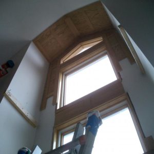

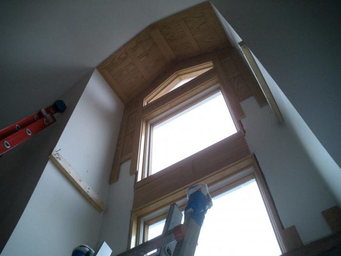

I’m trimming out windows and doors,  using 3 1/2″ fluted casing on the sides, butted into a pediment on the top.  One of the windows(46″ x 60″) has a trapezoid window(46″ x 31″) above it, with an 8″ space between the two, I’m  looking for some ideas on how to trim between the two.   Should the side casing go all the way from the bottom window to the top window, or start/stop between them ?  Anyone have a photo of a similar  job they did ?

    1. rez | Oct 30, 2006 05:44am | #4
       View Imagewhen in doubt add garlic
