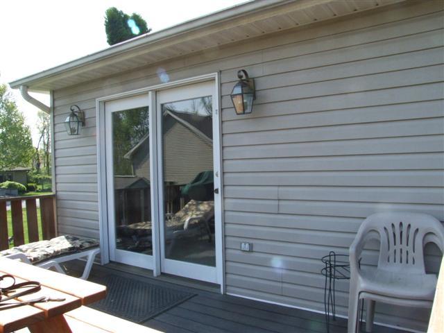

    can you please post a photo of the outside area showing the entire door and another showing the door and the overhang / roof line above  ?
    something like this:
    looks like a perfectly nice door, no ?

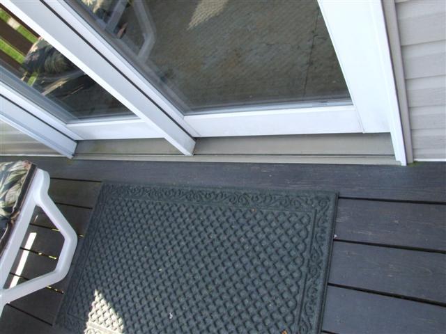

          Thanks for all the replies and info.  I've attached some photos of the doors in case anyone has any further thoughts on this.  I'm especially concerned about the brick facing appearing to be pulling away from the jamb (see photo #004).  I don't recall seeing any cracks in the brick; is it possible the jamb has moved inward?  Any suggestions on how to repair this?

            Someone needs to go there and put a level, or similar absolutely straight edge (or use a line--see below) across the door opening from brick edge to brick edge across door and across each corner and see if bricks have moved out of plane. Doesn't look like it to me. They can also site from back on wall, closing one eye and pressing open one close to wall, or preferably, site from a wall corner to verify that wall is all in a plane.
            (Pardon any spelling, typo errors I didn't catch, I'm at tail end of migraine and it does this to me. Though, come to think of it, spelling and typos are problems without a headache.)
            Do you know what the angle iron is fastened to? Hope it is to something structural like door header. Make sure that hasn't moved. The venner bricks above it may have moved out at right side, or maybe the angle was attacked to the door fraome and it has moved in--I couldn't tell from photos.
            My bet though is that if things are moving, it is the door and frame, not the brick wall . While whoever is checking out wall with straignt edge (even a stretched line will tell you a lot), have them put a level on the outside of the door frame--is it plumb, or is it leaning in or out?
            Answers to those questions will give you some idea of how to proceed. Good luck. I's difficult having a close relative live far away. Let us know what you find out and maybe we can offer more useful suggestions!
