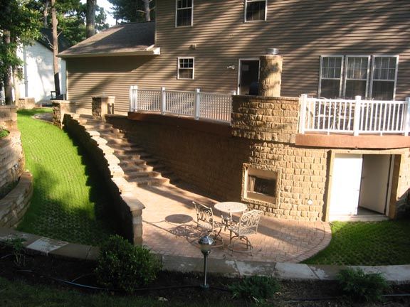

            Run 1/2" or 3/4" pvc conduit for your run and up into the columns.  The Anchor block system ends up with about a 6" x 6" void in the middle where the conduit can come up within.  Your column itself ends up being topped with a cap, or combination of parts to form a cap.  The combination type can still have a top cap about 12" x 12".
            This cap forms a watertight (as best as it can be) chamber which you can use as a junction box.   (Assuming low voltage.)  Carefully drill a hole (3/4") in the center of the cap for your wires to run.  And then, look in the plumbing supply shops for a mounting base.  About 3 1/2" in diameter, and a 1/2" threaded hole in the middle.
            Your low voltage lamp fixture should have a 1/2" male threaded base post to it.  Stick him into her before mounting the cap, leaving enuff wire to do your hookup.
            This light in the foreground is mounted into a Mighty Post which also has a 1/2" threaded cap.  Using the above description, three more were positioned on those columns in the background.  I ran the wire inside conduits in a big loop back to the transformer.  Be sure to understand your wire route ahead of time and build it in as the wall goes up.

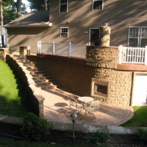

          4. MBaybut | Dec 11, 2008 09:55pm | #13
            Pete,
            Yes. Here's what I'm aiming for.
            Mike
          5. peteshlagor | Dec 11, 2008 11:09pm | #14
            Those post lamps look real big.
            Somehow, you're gonna need to run conduits.
          6. peteshlagor | Dec 11, 2008 11:11pm | #15
            Or,  skip the curved wall and put in an outdoor fireplace and grill combo.  Get rid of that cart in the background.
            Which way is the view?
          7. MBaybut | Dec 12, 2008 12:05am | #16
            The lights were a quick set up. They're not going to be anyware near that size. I've been looking into those stone blocks since you mentioned them, and I think that is going to be the way to go. It'll save a ton of time not laying the block and not installing the veneer. It may well work out cheaper. I was thinking of just installing an outlet near the 1st column, then running a low voltage cable for the lights. If I set the first course of stone block raised up 1/2" on a channel of mortar I could run the cable in the middle the pick up in the columns going along and using low voltage fixtures. What do you think?
            Thanks so much for getting me a thinking,
            Mike
