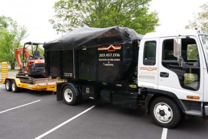

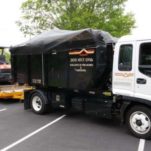

For years I have been using a dump trailer for our site waste. We never have room for a large container. Recently, with multiple jobs going the dump trailer is always tied up on a jobsite and we are left scrambling for an empty trailer.
This problem has forced me to look into a rack body dump or small “Masons”(1.5 ton) dump truck. After searching for a used version of the above and estimating the average life of the investment we arrived at the conclusion…….not a good return on the investment.
We needed something that could efficently tow our compact excavating equipment, remove our construction generated waste, doule as a dump truck for misc. building supplies, last for 300,000 plus miles and not be overweight at random DMV checkpoints in our area.
Enter…….Isuzu FRR with 12′ Switch-n-Go detachable body system.
It cost and weighs far less that a hooklift body system. Containers should last us 10 years plus and the towing and fuel economy are excellent. It cost about the same to insure as my 2003 Sierra 2500HD (which I am now looking to downsize).
I would highly recommend looking into this style of truck of at least the cabover chassis with the rising cost of fuel. They are very economic to drive and very long lasting.
The Switch-n-Go has many detachable body options including containers, flatbeds, rackbodies and enclosed storage boxes.
Here it is:

    very nice. What did that cost?
    1. TTolla | May 29, 2008 06:06am | #6
      Total truck cost was $ 31,000 which is 10K less that my 03' 2500HD with 8 liter and allison trans.

          The chassis is a 2001 Isuzu FRR (gvw 19,500). It was purchased used from a private owner with 85K miles. He actually used it to tow his fifth wheel camper! It is equipped with an Isuzu 6H 472 cu. in. inline 6cyl.Here are the specs from ISUZU:FRR
          The Class 5 FRR offers an 18,000 to 19,500-lb GVWR. It has a 7.8-liter six-cylinder Isuzu engine delivering 200 hp at 2400 rpm and 441 ft-lbs torque at 1500 rpm. The standard transmission is an Isuzu MLD6Q manual six-speed with overdrive. An optional Allison AT542 four-speed automatic transmission is available. With wheelbases of 148", 167", 179", 191", and 218", the FRR can handle bodies from 14 to 24 feet. It has a 34"-wide steel frame. Daytime running lights, ABS, built-in door beams, padded low-rounded dash, non-slip entry step, grab handles, and 85° door openings have been added.My truck is equipped with an engine exhaust brake (Jake Brake) and six speed manual transmission.The hoist system I used is a Switch-n-Go. As I mentioned in my original post I chose this system for its true dump angle and over all cost over a hook-lift. You can read more about their system here:http://www.switchngo.com/switchngo.htm?gclid=CLCTj-D0y5MCFQwaHgodd3S1hQWe have two medium duty containers and a flatbed for hauling the skidsteer ...the mini-excavator weighs too much to be sitting 4' above the pavement so it rides on the trailer.It was an investment for sure but since we never have been able to deal with rental containers clogging our tight sites and with my quest to become more efficient........this seems to be workingHere is what the truck looked like on the way home from Florida..... before we performed surgery ( see attached)PS: I do let my excavating contractor perform the larger tasks............sometime.......

            Thanks for the complete specs.  Looks like you found a good buy on a nice unit.  Glad it's workin' out for ya.
      2. ravz | May 29, 2008 05:47pm | #16
        Is that including the bin?
        1. TTolla | May 29, 2008 06:00pm | #17
          Here is the breakdown:2001 Isuzu FRR chassis $ 16,500Switch-n-Go hoist frame and bumper $ 10,30015 yd medium duty container $ 2,800Rear fender kit $ 300Two under mount storage boxes $ 900Total cost $ 30,800

    Great truck. Out of all the trucks I've bought that series is me favorite. easy in/out, good turn radius, nice handling. When our drivers swap trucks those aqre always picked up in a hurry.
    But, Izuzu stopped making that size. You can go up to a T series, about 26k GVW or down to 14k GVW. That 20K GVW is just right for us.

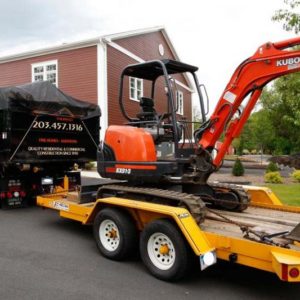

    Have you had any issues with towing? Your box (12') is a bit shorter than ours (18'). i've always been scared of loading too much on ours. Get over 20k weight.
    How is your gross weight when towing the excavator?
    i got tired in about 01 in buying clutches. So our 01 is the first one in our fleet that is auto trans. I really like it now. Wouldn't go back. Our 01 probably has 200 k miles on it or a little more. Great, great workhorse truck. You'll get a lot of work out of it
    1. TTolla | May 31, 2008 06:42am | #23
      The empty weight with the can shown is 12,006 I have never been able to overload the can with construction debris....unless it's drywall of roofing. I have never been able to find out what the CGVWR is for truck and trailer but the trailer and mini-excavator is 9,400 #I could have purchased a truck (WT5500) with 14" S-n-G but I was afraid of over loading a larger can.
